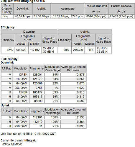

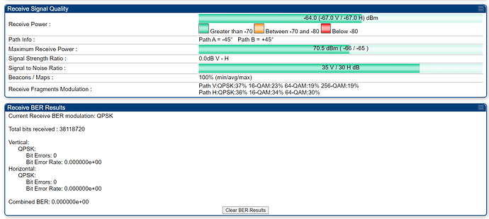

Thanks Eric⦠I have reviewed some of those in the user guide but will look again⦠I am choosing the channel with the least noise⦠its average is -85dbm⦠these are the results of one SMā¦
The MIR profile is set to 75 down and 10 up, based on the stats in these shots is 40mbps down what one should expect?
Are any of these nNLOS links? If some of these SMās are nNLOS and/or experiencing intermittent noise from a nearby high power LTE transmitter, then yes, at 20MHz channel width, the speeds youāre seeing would not be out of the ordinary. At this point you might want to reach out to your RTM or raise a support ticket to review your settings and findings.
Assuming 20MHz channel width or greater, using a 450b SM, then yes, I believe 75mbps down could be achieved.
Thank you⦠yes its a 450b high gain connected to a 450m 20 mhz channel⦠did a link test with bridging and got 82mbps (62 down 20 up) aggregate⦠I have the 450m set to 85/15⦠I put the QOS on SM at 75/10 and did a test with bridging an MIR and got 45 down and 11 up⦠test says transmitting at 8x/8x MIMO B
On the AP, if you look under Session Status ā Link Quality, what do the stats for the SM in question look like? Specifically, the Actual Average Rate vs. the Expected Rate?
Looks good to me! I really donāt understand why youāre not seeing higher speeds. ![]()
Me too⦠I opened a ticket with cambium but not getting anywhere⦠the one engineer said 75mbps is not achievable in 20mhz channel⦠![]()

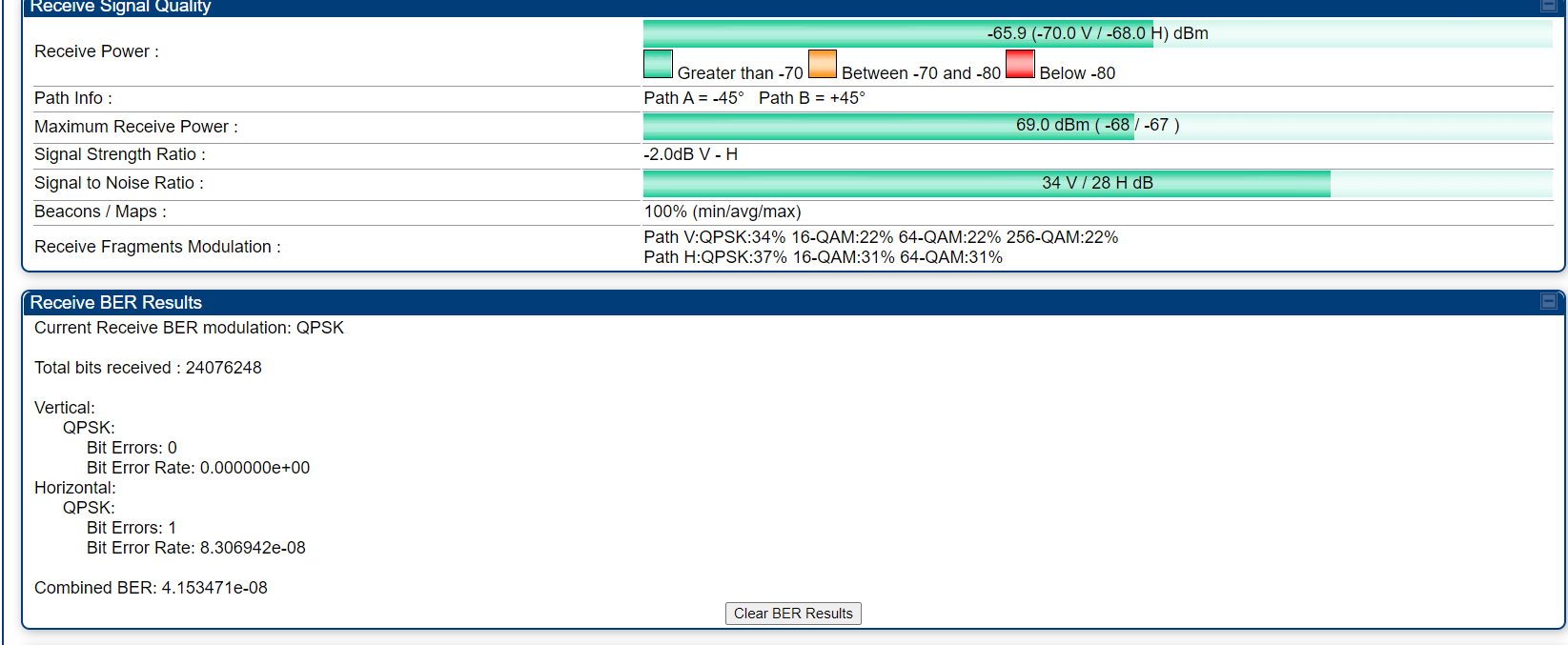

This is the next door neighborā¦
Can only get 45mbps down⦠I have epmp radios performing better with worse stats lol⦠this is very frustrating especially when this stuff is so hyped
