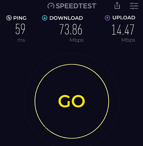

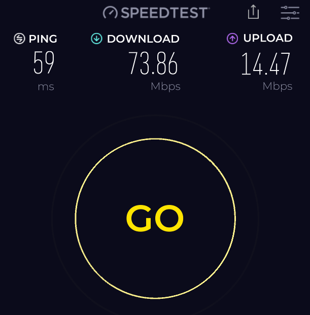

We are still experiencing link test and speed test discrepancies. Also seeing higher ping on SMs with the 4500 opposed to 3000 we had before putting in 4500, same amount of SMs before and after swap, 48 SMs. I know some have mentioned scaling issues, so maybe that is what is happening. Definitely need a fix, been a bit underwhelmed with the 4000 series, I made a comment on a different thread, sorry cant remember which one, showing one of my Force 300-25 having no issue delivering 100mbps to a customer and a 4525 struggling.
