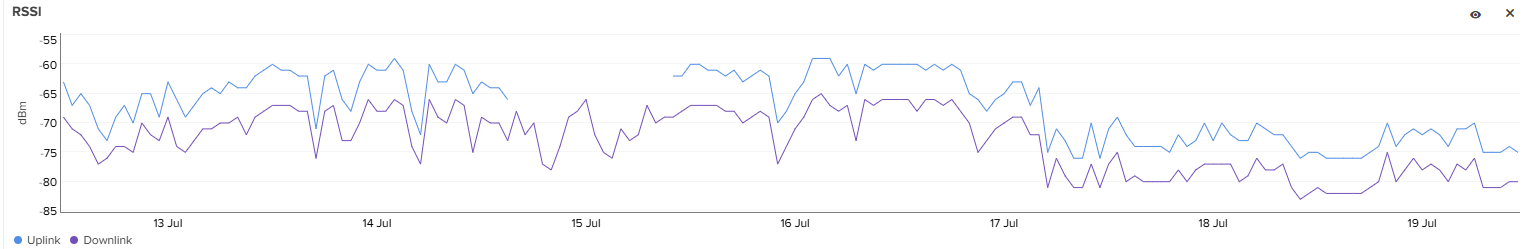

Will do Andrii, here is the last 7 days from a SM (its actually my SM on my house) and my SM is connected to a different 4500 AP on a different tower and I am seeing the swings.
As per the graph I had a substantial drop overnight
What is your terrain and environment? To me this looks like thermal fade. Where I am at I see this the most during June-July from certain SMs. Our area is mostly flat land, but we have many fields with crops that give off significant heat and humidity along with it being very humid here as of late.
