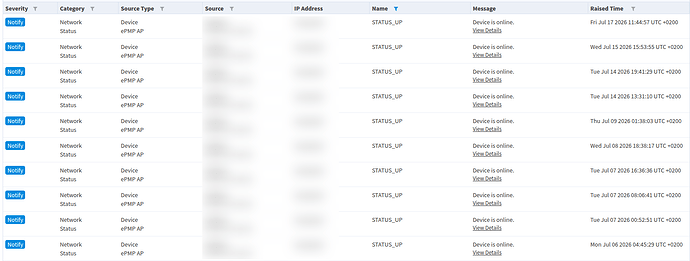

Hi, we have the same problem. Has any fix been released? We have noticed a lot of reboots and looking into log messages, we have found the same message.
Environment
  • ePMP 4500
  • Software version 5.10.4
  • 20 clients connected
