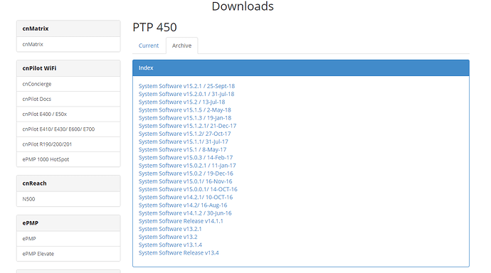

I had some of the radios working fine for this application. But some are not.is it because of they are purchased on different times and having different software versions? or slave and master are using different version ? can  changing software version help me ?? Recently I found that there are many versions of software.
As a rule of thumb I like to keep all my radio's software up to date with the newest stable release. If some radios are running a very old version, there could be bugs or other issues that are effecting performance. It might be wise to focus on one radio or a link first and get that running stable and then focus on other radios instead of updating everything all at once. Take steps to having everything up to date.
PTP 450 had so many updates on last year(2018) , and I don’t know what software versions in each radio . We had different purchases different times in 2018 so I might be having different software in different radios. That is why I doubt on soft versions  .May be master and slave in a link having different  software versions
