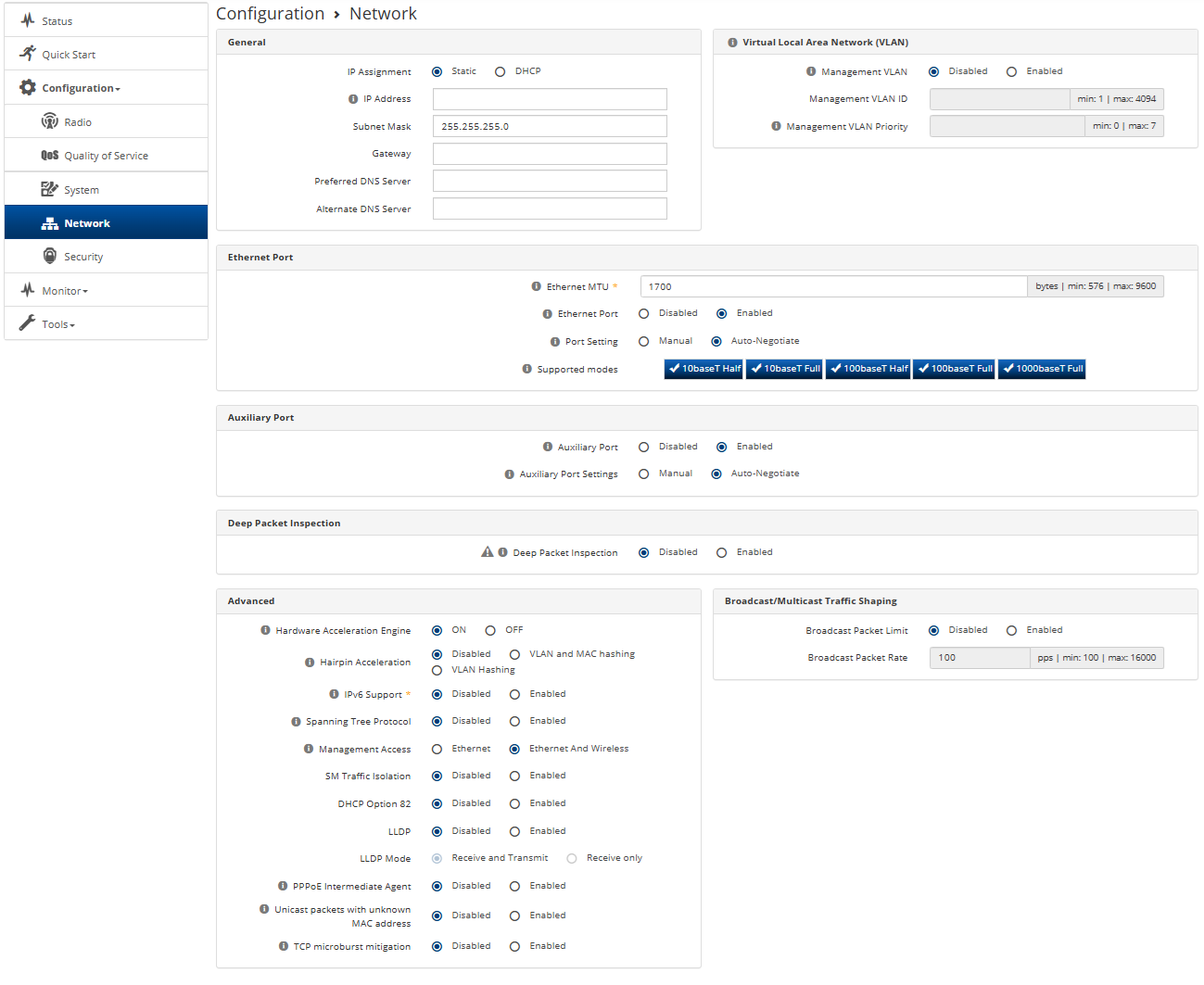

Do you folks use PPPoE? Anyone use LLDP? Do all radios have some sort of firewall protecting them from the broader internet?
Just a few notes on our ePMP network…
  • We don’t use PPPoE
  • We don’t use LLDP
  • AP’s use private IP addresses
  • All SM’s with public IP’s and using NAT have common mgmt ports firewalled upstream

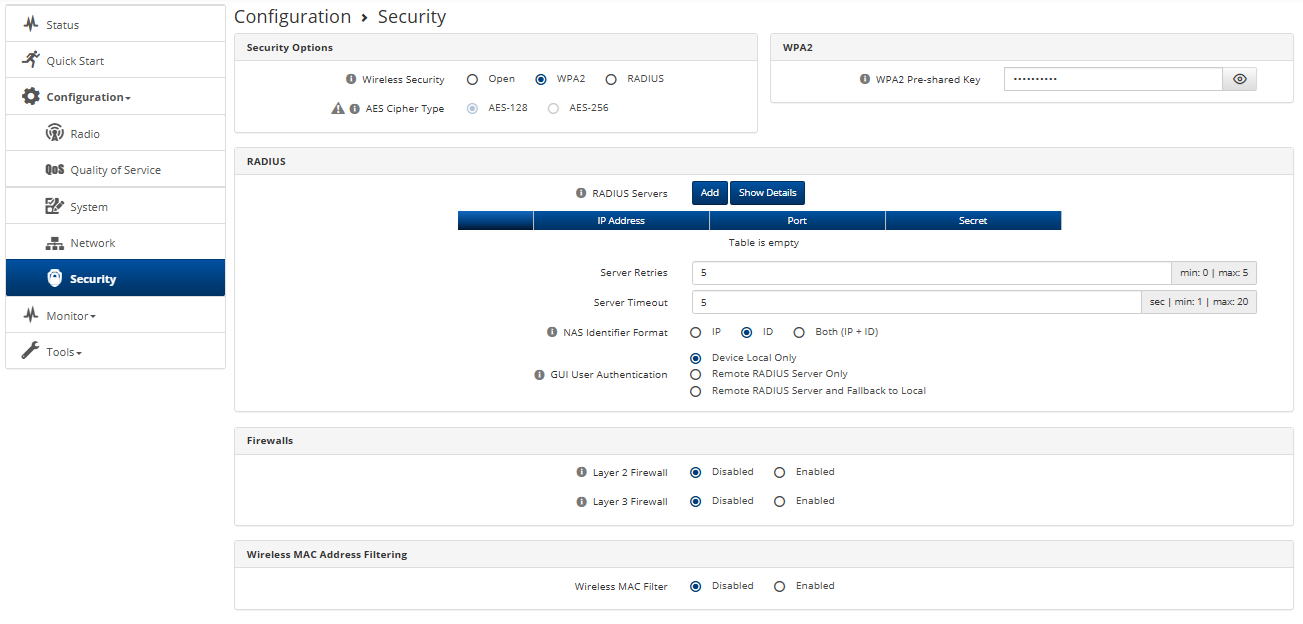

  • All radios have every service and option disabled with the bare minimum needed to operate

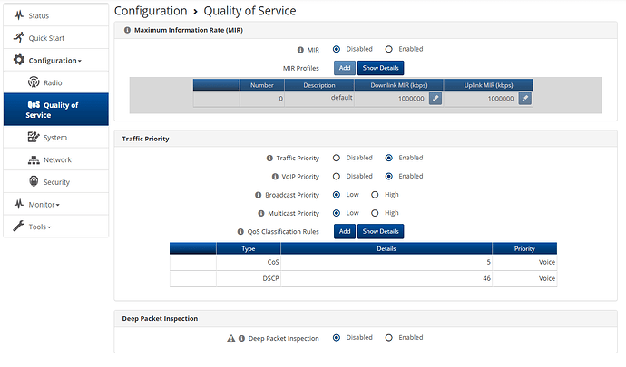

  • We do not use traffic shaping on the radios (but we do have the QoS settings enabled)
  • IPv6 is disabled
  • AP’s are set to bridge mode and the vast majority of SM’s are set to NAT mode (there are a few set to bridge mode in order to provide static IP’s to select customers)

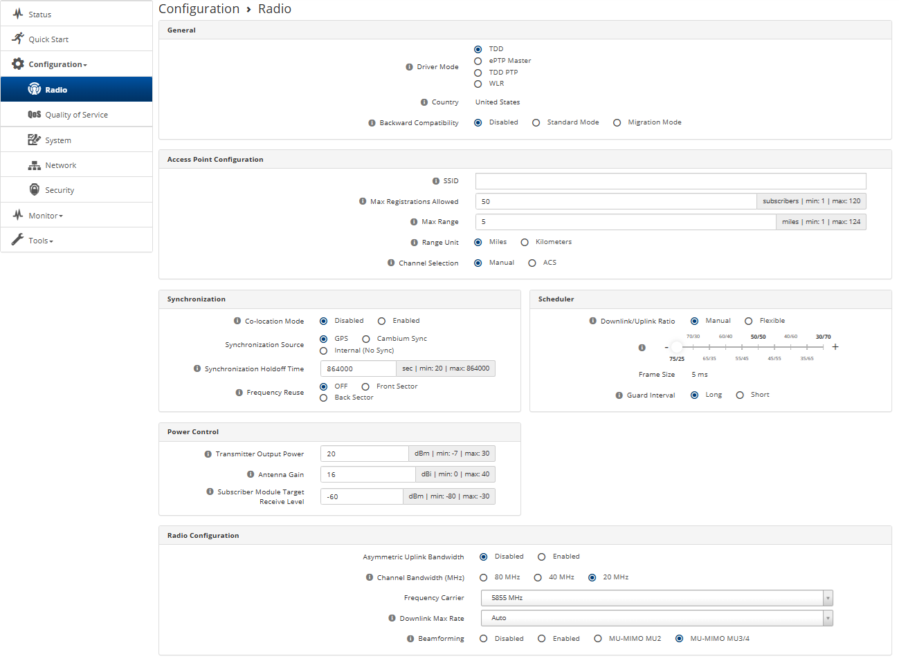

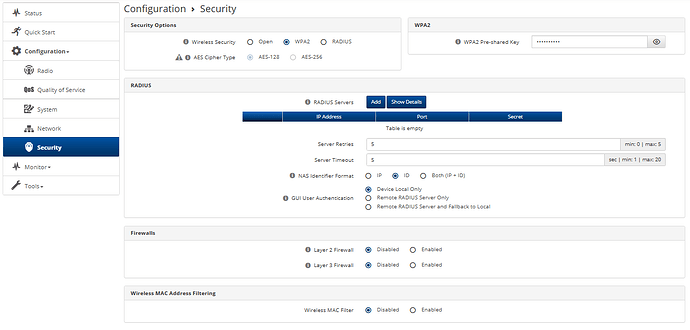

  • We use fixed mode TDD with a 75/25 duty cycle 5ms and GPS sync for all AP’s. Most AP’s have the option of both onboard GPS and ethernet sync injection
Here are some example screen shots of how most radios are configured:
