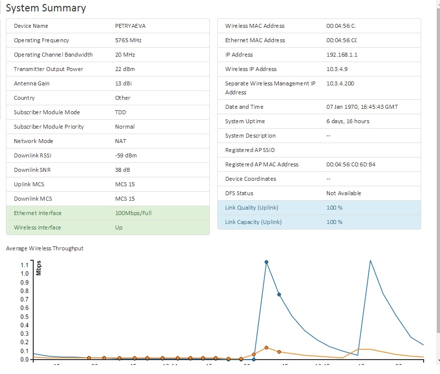

My wireless stats

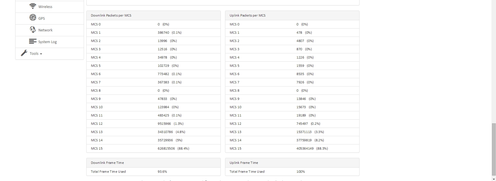

Any updates to this?  Is it being worked on?
We see upload total frame time at 99.7% on all of our ePMP1000 GPS APs in 75/25 mode.  Downlink is around 3% at the same time.  Total traffic on the AP at the time is between 20Kbps to 1.2Mbps on downlink.  Uplink did not come off the bottom appreciably.   When users are active we tend to see up to 11Mbps downlink and 400Kbps uplink.  We are running 2.4.1 on two sectors and 2.4.3 on the third.
I changed the ratio to 50/50 on all three 2.4GHz sectors and the upload total frame time on all three sectors is now 99.8%.
Maybe the math is just getting done in the wrong order or with the wrong sign and it is actually 0.3% in 75/25 and 0.2% in 50/50?
Hello lambert,
There is a know issue with the reporting of the UL frame utilization. It either always about 0% or 100%, and it does not accurately reflects utilization of the UL. We are aware of it and the fix should be included in a future release.
Regards

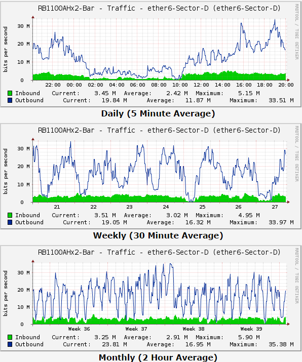

I made investigation of the issue.
We have excelen test site. Sector A has 15 subscribers, sector D has 45, so totally 70. All of them are int the area about 120 degrees.
I droped users from havy loaded sector, than start to move users by 5 back. I did measurement  by wireless link test from one user. There are link speed degradation correlated on number of users.
Speed degradation
According to the monitoring total upload utilisation never rich 5,9 Mbit which is much less of capacity of the system.
Software version is 2.4.1

Can you post a screen shot of your wireless connections from the access point ? As well as a screen shot from the performance tab ?
