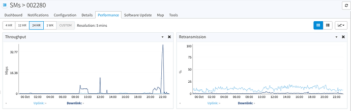

We already use full radio power from sector side, but with sector antenna 120 degree (MuMIMO). About retransmits, plz look at picture from cnMaestro:
!!! Customer side !!!
!!! Sector side !!!
As you can see - on download retransmits is low, so i cant find good excuses why it’s happens.
