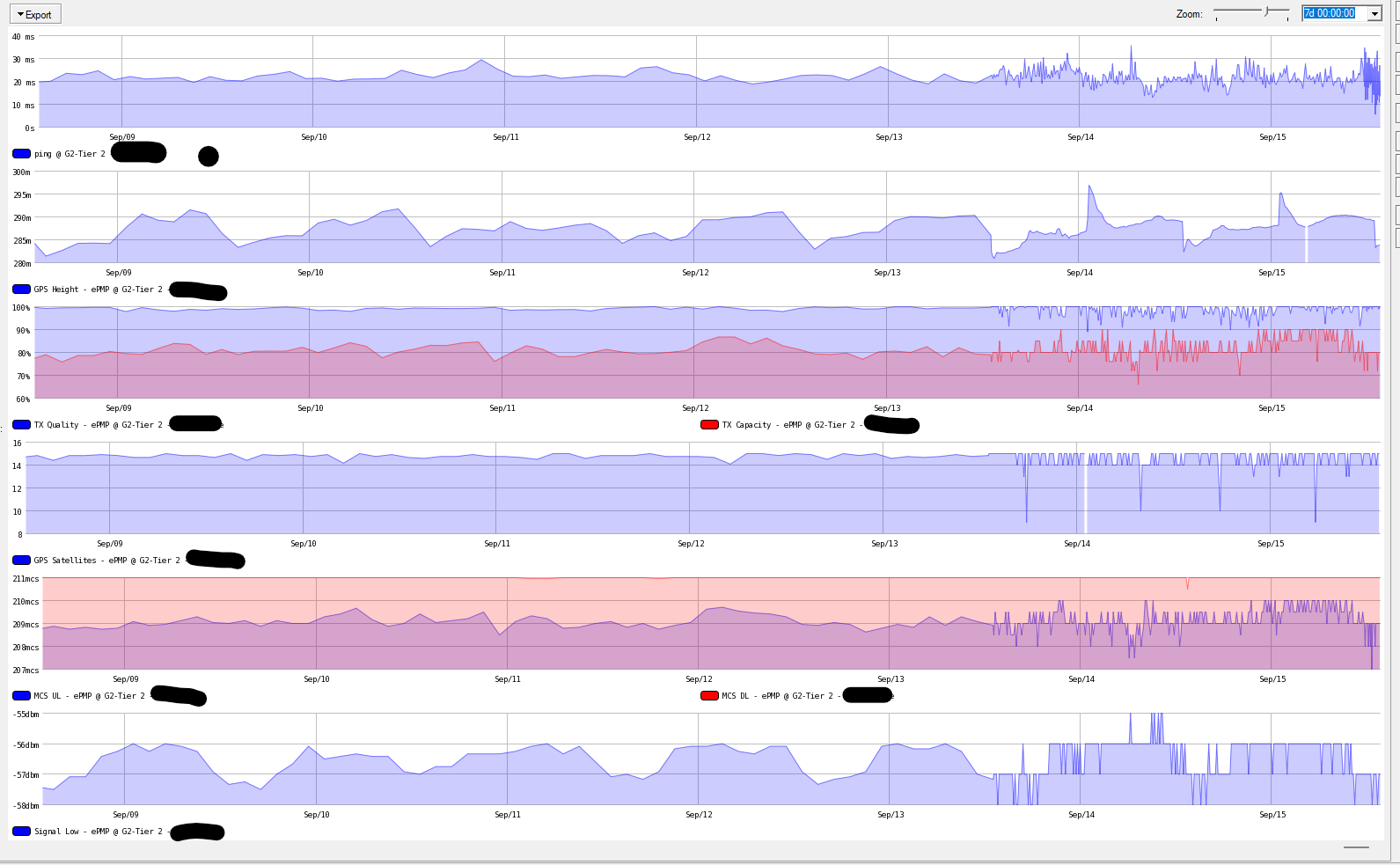

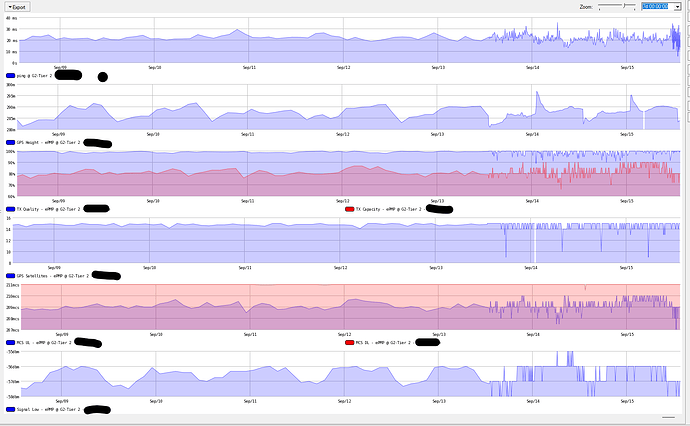

I am using The Dude (SNMP) along with cnMaestro. I use The Dude to probe ePMP for the following.
SM
  • GPS Height
  • GPS Satellites
  • LAN Status
  • MCS DL
  • MCS UL
  • RX RSSI
  • TX Capacity
  • TX Quality
  • TX Power
  • SNR
AP
  • DL Frametime %
  • GPS Height
  • GPS Satellites
  • GPS Sync Status
  • LAN Status
  • TX Power
4625 SM Charts
