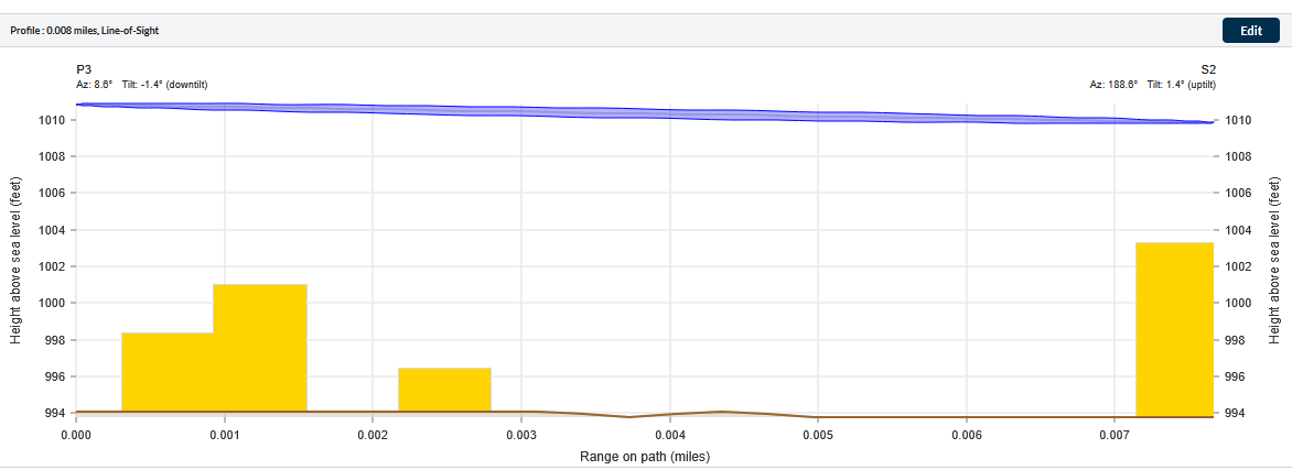

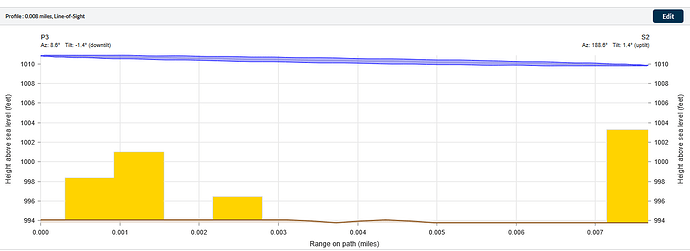

Unfortunately this feature wasn’t ready in time for the 6.3.3 release, but it will be in 6.3.4.
The azimuth and tilt are now shown below the site names in the path profile chart.
The tilt will turn red if the link is non-LOS to indicate that the tilt is calculated to clear the obstruction.
