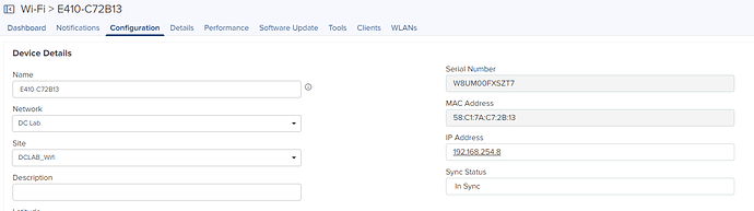

This is the MAC address that cnMaestro shows for this AP:
58:C1:7A:C7:2B:13

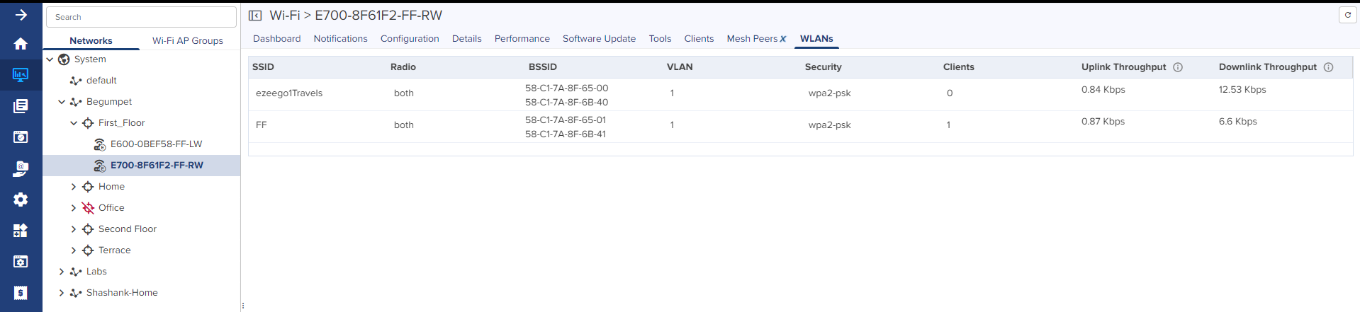

The AP is configured as a switch. Each 'leg" or port of the switch has a different MAC address so that traffic can flow through the AP properly. AP’s have at least 2 MAC addresses - one for the ethernet port, and one for the radio port. In Cambium’s case, there is a MAC address for the ethernet port, which is the MAC address that cnMaestro shows in the configuration tab, and 2 MAC addresses for each WLAN configured - one for the 2.4 Ghz radio, and one for the 5 GHz radio. You can find these MAC addresses in cnMaestro in the WLAN tab of the AP.
This is the configuration tab:
This is the WLAN tab.

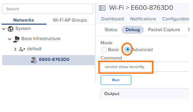

AP UI or cnMaestro UI display 3 main mac addresses of the device. One is Device MAC address and other 2 are 2.4GHz & 5GHz radio MAC addresses . If you have configured any no.of wlan’s on the AP then you can see all those mac addresses information in “service show iwconfig” command output. I guess you are looking for these mac addresses information on the AP. This command will display each wlan/VAP mac address.
To run that command you have 2 option one is ssh to AP and run the command or from cnMaestro Tools page you can run that command(refer the image pasted below)
cnMaestro–> Tools → Debug → Advanced Mode and run the command
