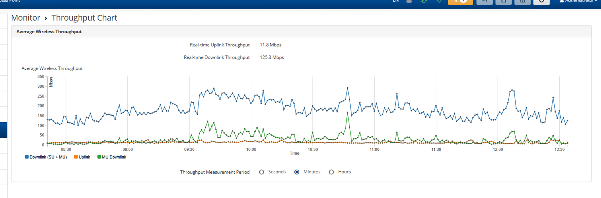

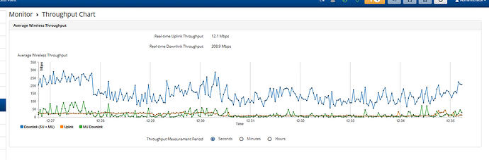

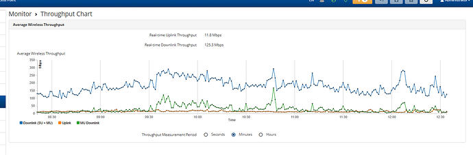

For us, the 5.12RC provided by Cambium saved us from loosing a lot of customers. Now Ookla tests are much better and also we can now see some MU in action. The upload Ookla tests are still far from good but I’m pretty sure Cambium will get there. Peak hrs nearly 300mbps with 50 CPEs. 50% Frame time used.
