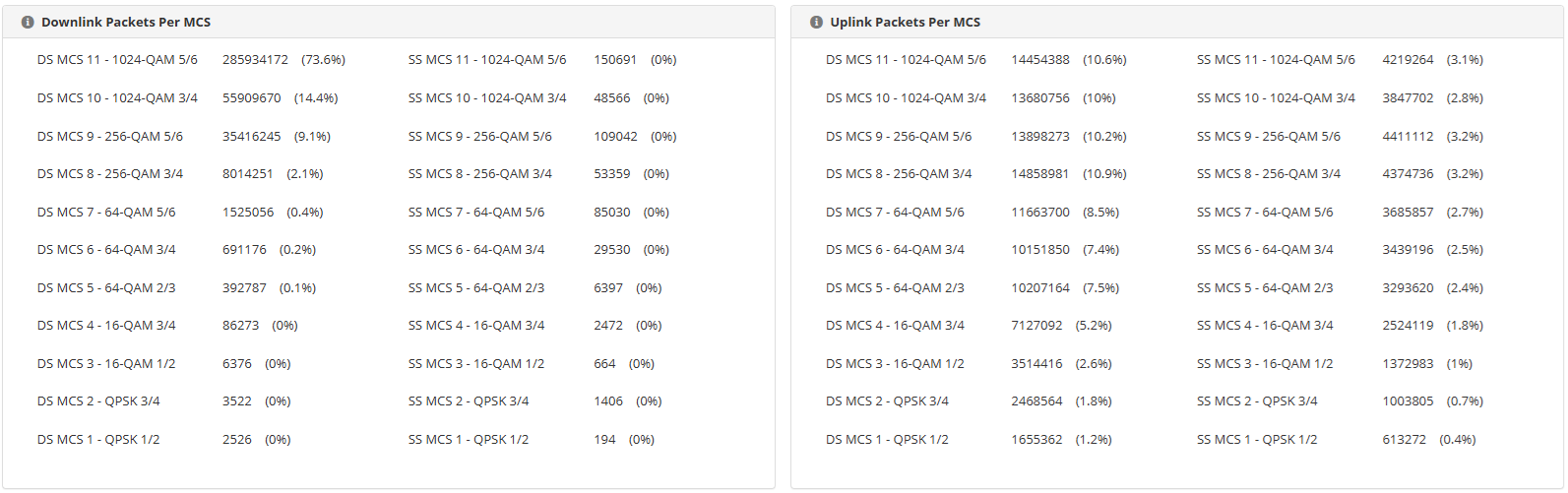

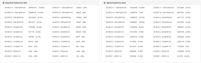

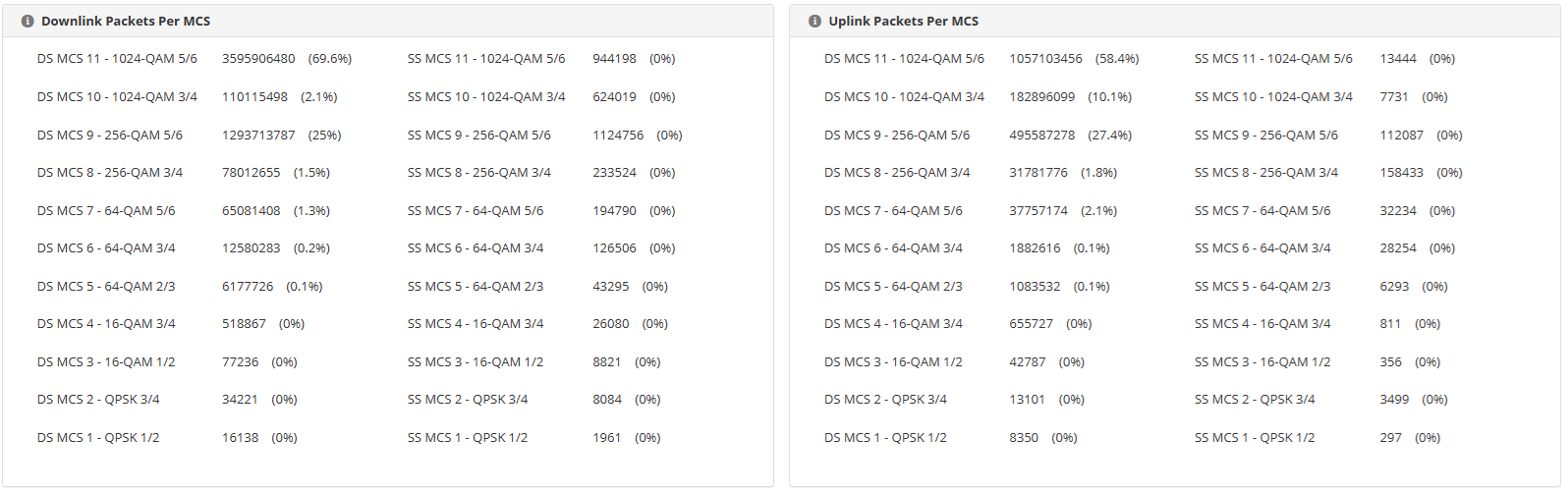

It depends on the AP… some the latency/jitter are OK, some have really bad latency/jitter. We’re working with Cambium to try to determine what is causing these issues. That being said, these latency/jitter issues seems to be related to a higher % of UL packets being sent at low/poor MCS rates.
Here’s an example of an e4k AP that has pretty good latency/jitter across the board for most SM’s:
Here’s an example of an e4k AP that has very high latency/jitter across the board for most SM’s:

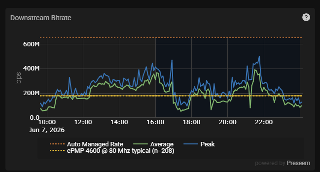

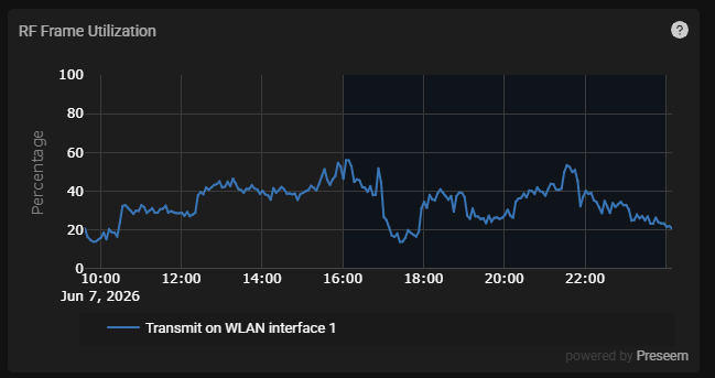

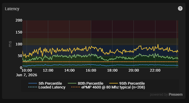

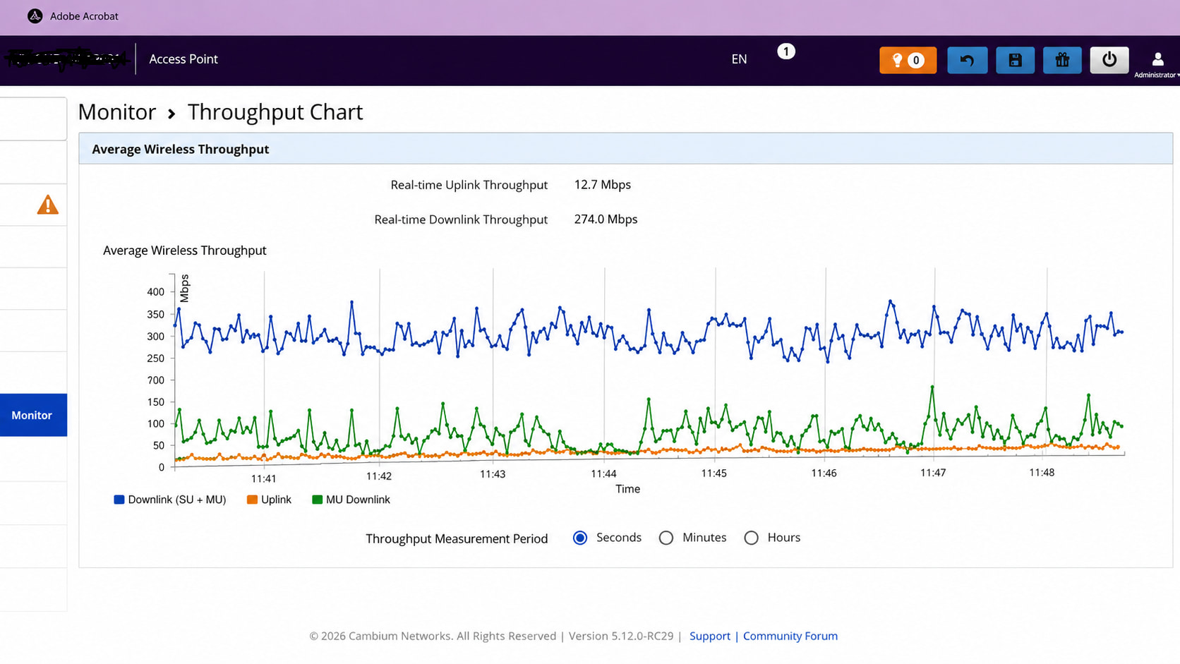

Might not be relevant as this is a 4600 AP instead of a 4500 AP but here is what I see on a 33 client AP with MU-MIMO enabled. Still has scaling issues IMO as TCP especially is not where I think it should be when doing testing.

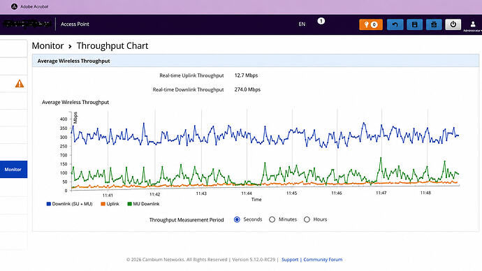

It works well, last night hit 170 Mbps on Mu mimo traffic was about 350 - 370
