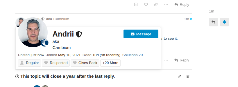

Hello @micampo,
you can use the direct message button of this community. Just push user’s avatar to see it.
