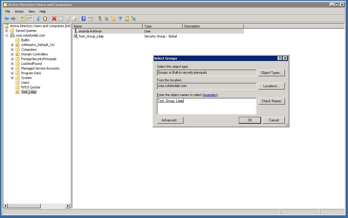

Add the user to a group
Search the group to which the user needs to be added and click on OK
User successfully added to the group

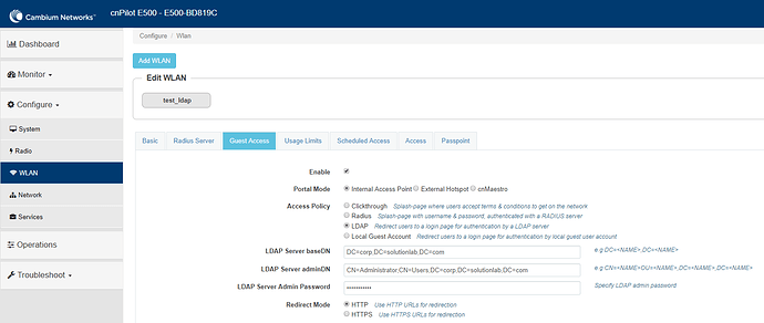

Configure LDAP server credential on the cnMaestro/AP
In cnMaestro, Ldap guest is available at shared settings > wlan > wlan name > guest access
Below configuration is for default Administrator user which is part of Users
In cnMaestro, LDAP IP address is configured at > AP_Group > Group name > Services >LDAP
In Access Point, LDAP guest configuration is available Configure> Wlan > Guest Access
In Access Point, LDAP IP address is configured at > Configure> Services > Network > LDAP
Order of DC, OU and CN
Make sure that the order of configuring the DC and OU and CN are correct so that we do not have any issues in binding the AD. Here in this example, order is like this,
CN=James,OU=ldap_OU_Test,OU=Test_Ldap,DC=corp,DC=solutionlab,DC=com

For the below example, cnMaestro/ AP configuration is,
Note: We do not need to add OU here since “sadmin” user is not added to any group
