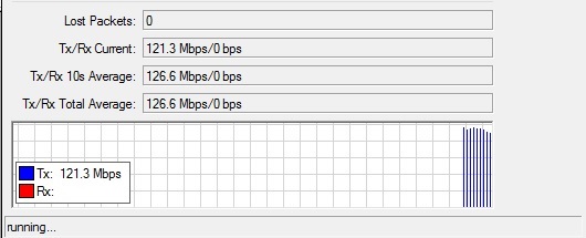

The "Wireless Link Test" tells me the Downlink is around 70Mb +- on both of these links but when I run a bandwidth test with the Mikrotik Routers I'm seeing 100Mb+- on the TCP test.

does that test each direction one at a time?   i'm curious if your getting similar aggregate results.   the wireless link test i believe does both directions at the same time, and if your test one way then, the other your going to get a higher reading than the built in load test, but should see a similar aggregate capacity.    the eptp isn't a fix up and down ratio.

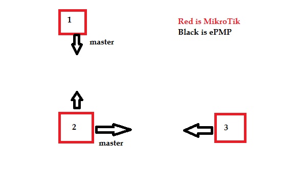

Today I was troubleshooting link 2 to 3.

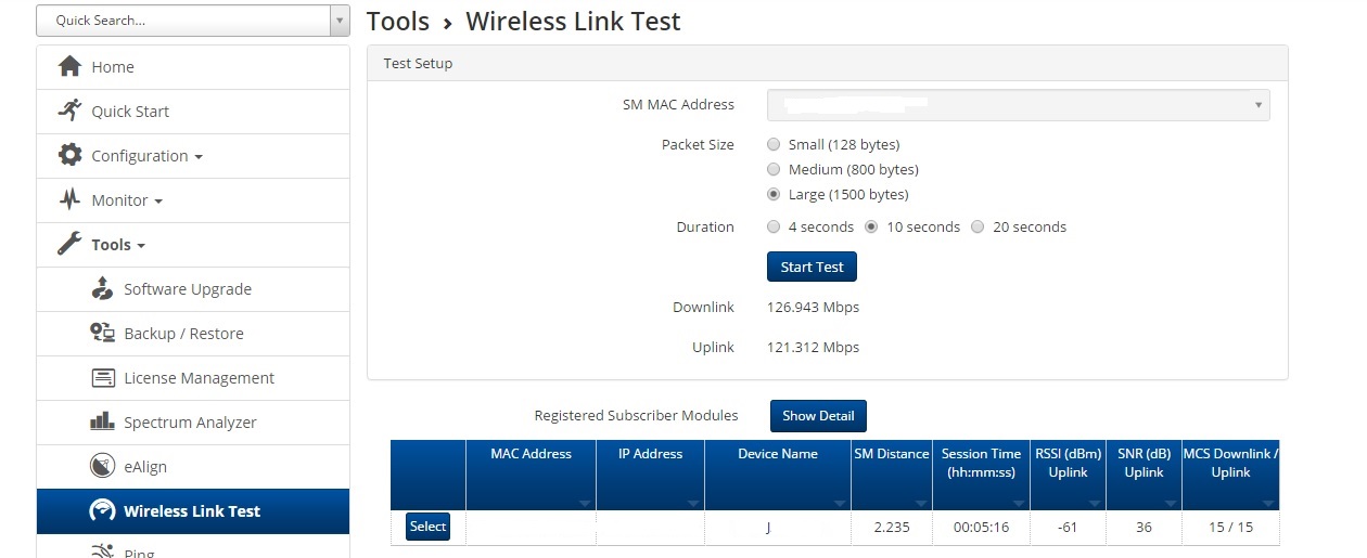

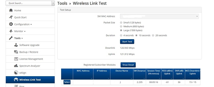

Just wondering but when you run "Wireless Link Test" will it only show whats left in the link if there is other traffic?
Heres the Wireless Link Test results
Downlink
49.525 Mbps
Uplink
68.194 Mbps
1 to 2 was around 90Mb
Agreed with Chris. Wireless LInk Test is doing both directions while your mikrotik btest utility in the screenshot shows one way traffic. In non-(e)PMP radios you can specify test directions etc but not on ePMP at this time.
