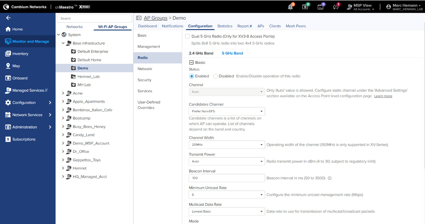

Next, select Radio. From here you will make changes to channel settings, transmit power, and affect both roaming and interference mitigation capabilities. This is where the several changes will occur from the default settings. I highly recommend following the options that I have selected below for the vast majority of deployment types.
Each radio in the AP is configured separately. Be certain to complete configuration changes for both the 2.4 GHz and 5 GHz radios. The menu starts with 2.4 GHz, so we will too.
2.4 GHz radio
Enable. From here you can choose to enable or disable the 2.4 GHz radio. There are times, especially in very high density deployments, when you may choose to disable some of the 2.4GHz radios, using only 5 GHz. For this, you will want to create two different AP Groups. One with 2.4 GHz enabled and one with 2.4 GHz disabled.
Channel. I recommend leaving this at the default setting of auto, allowing the APs to choose their own channels based on RF conditions.
Candidates Channel. This is the place where you can assign a channel, or a series of channels to a radio.
Channel Width. I recommend using 20 MHz. It is possible to use 40 MHz, but it is rare that the 2.4 GHz environment will make this a wise choice.
Transmit Power. I recommend leaving this as Auto as well. We will make other configuration changes later that will allow the APs to best choose when to turn power down and when to turn it up.
Beacon Interval. Multicast Data Rate, Mode, and Candidates Channel. For the majority of deployments, I suggest leaving these settings at default.
Minimum Unicast Rate. Changing this value will tell the AP to advertise to all clients that it will only accept clients that can connect at this minimum MCS rate. When left at the default of 1, clients will attempt to connect at the far reach of the AP, even when conditions are poor enough that connections are not guaranteed. To make this worse, some clients tend to stay connected to an AP when they should roam to another one. By raising this value, you will shrink the cell size of each AP, but you will also do so in a manner that both ensures more solid connections between AP and client and will encourage clients to roam more quickly. At a minimum, I suggest raising this value to 2. If you want to exclude all 802.11b clients, raise this value to 12.
Airtime Fairness. Enable Airtime Fairness in order to prevent slower 802.11b and g clients from forcing the faster 802.11n clients down to their speed.
Short Guard Interval. This sets a short guard interval between the packets allowing for more data being passed in the same amount of time.
Enhanced Roaming. Do not enable this feature. It is a nice feature to have if you have very sticky clients, ones that absolutely refuse to roam. But it is a harsh approach that can better be served for most clients by adjusting the Minimum Unicast Rate as mentioned earlier. Fortunately, very sticky clients are quite rare today.
Channel Scan. Enable Continuous Background Scan (default) and use the default settings. This will tell the APs to continuously scan other channels in order to build up a reference table of which channels to use if a channel change becomes necessary. This will not drop clients. Enable CBS for APs running CAOS v6.x. Disable for APs running CAOS v4.x
Auto-RF - Dynamic Power. Enable this feature using the default settings. This will tell APs to turn down their power if they are in close proximity to another AP running on the same channel with enough power to cause interference. If that changes later, because one of them fails or their channel changes, the AP will then increase power again.
Auto-RF - Dynamic Channel. Enable this feature using the default settings. This will trigger the radio to change channels if certain RF conditions currently exist. If you select any option or combination of options (Packet Error Rate, Channel Utilization, Noise), you will also have to configure the thresholds that when met will trigger the radio to change channels.
Save your configuration.

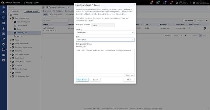

Onboarding APs to your new AP Group
The next step is to onboard your new APs. If you have already done this, you don’t need to do this step, but you will want to assign each AP to an AP Group. In most cases, that will mean that they will all be in the same AP Group. If you started fresh and did the steps in the order I have outlined, then you can import your APs now, assign them to a Site, and assign them to an AP Group all in one step.
Click on AP Groups in the blue menu on the left. Even though you were already editing your AP Group before, this will bring you back to the main AP Group menu where you will see your newly created AP Group along with the Default Enterprise AP Group that we provide as an example. Click on the name of your AP Group and you will be brought to the Configuration page for that AP Group. Go to the Dashboard page. It won’t be very interesting initially as there are no APs assigned to it, no clients, and no traffic. But we will solve that now.
Click on the menu option in the grey bar near the top that reads APs. At this point, there will be no APs listed, but you will see a button to Claim a New AP on the right-hand side. Click on this button.
What you will see will look like what is shown above. The first thing you should note is that you have a drop-down box to select one of the Sites that you created. You do not need to assign a Site here, but if all of your APs in your AP Group are located at one Site, it is convenient to set that now.
Next, type in the MSN for each of your APs in the box. You can separate these line by line or just with a comma. You can also use a bar code scanning to scan the bar code on either the box or the AP itself for the MSNs. Save this list to a CSV file and then import it using the Import .CSV button. Once you have typed and/or imported your list, click on Claim Devices. You can follow the progress as they contact the public cloud and come online.
Hint. If you are impatient like me. Either do not plug in your APs until you have already entered their MSNs and clicked on Claim Devices or reboot the APs right after you do. As soon as the APs finish booting up they will reach out to cnMaestro. But if they have been plugged in a while, they will only reach out to the server every few minutes. If you are caught in the middle of this cycle, rebooting will ensure that it happens right away.
