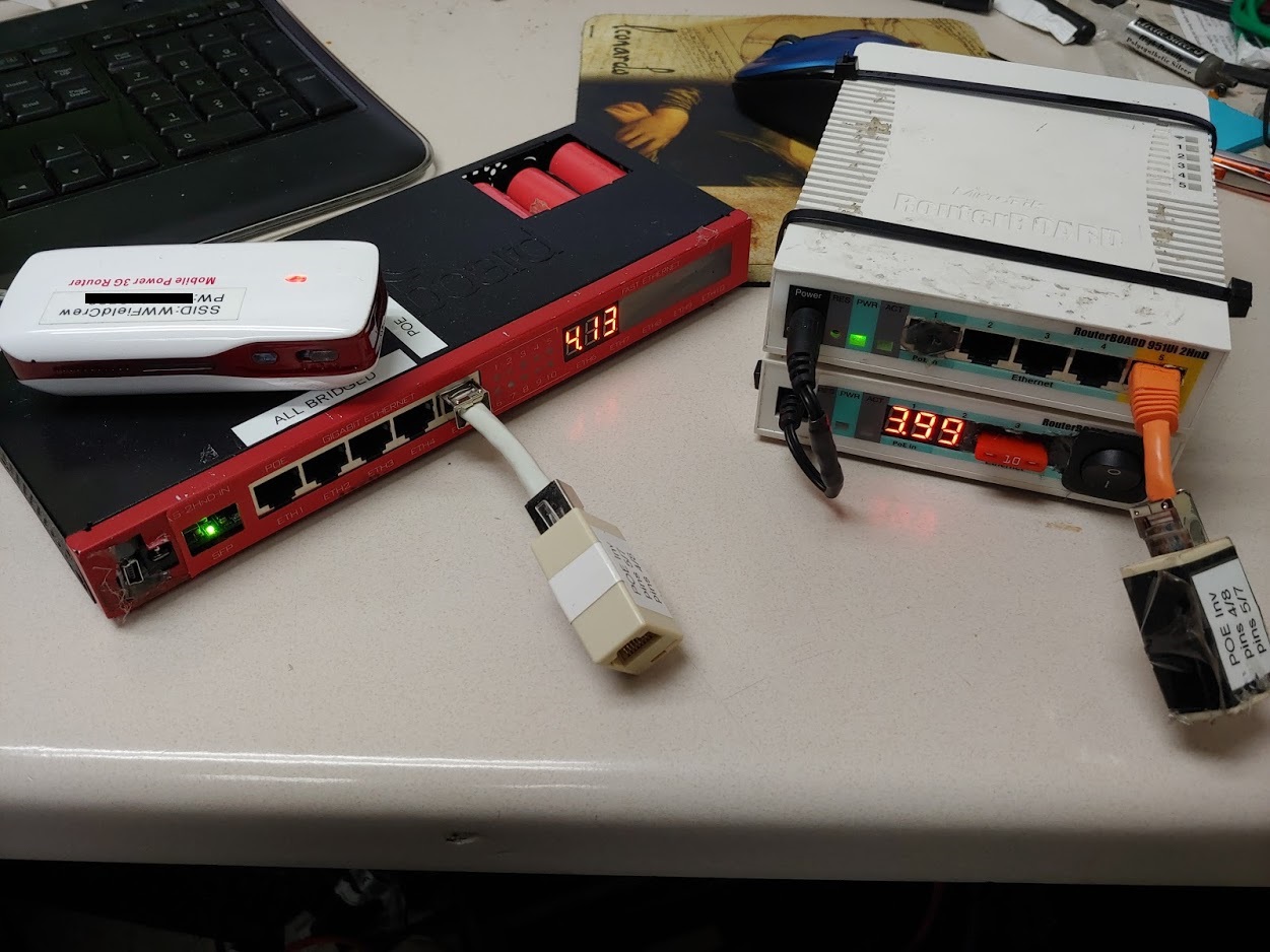

I have been building battery routers that issue the crews device a 169 to get to the radio. They work great for epmp1000 SM modules, i have them at 25v output, but it doesnt have the amperage to do pmp450 gear due to how i have it setup.

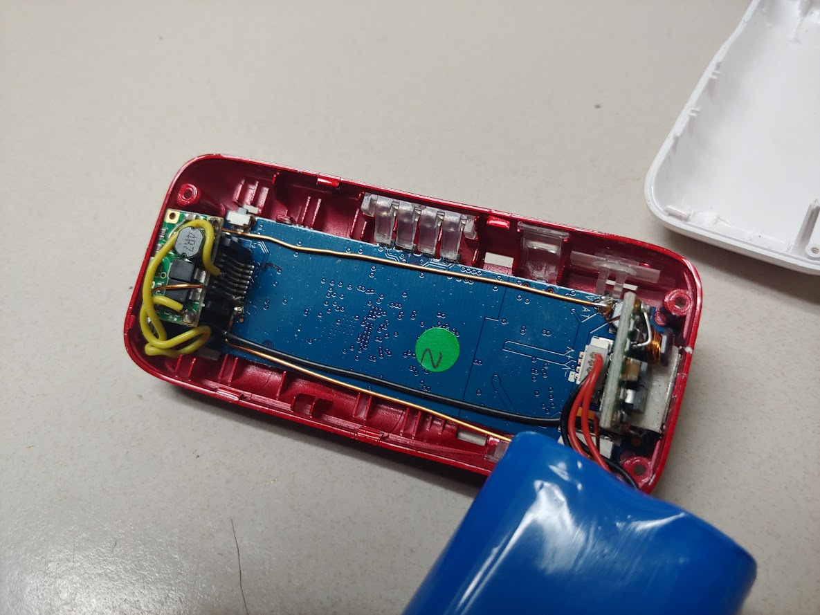

That is the same as the Geva unit in my picture lol, but 15w vs this 8w.
Literally a rebrand, the login creditials are still Geva creds "v3 root/gevaach" lol, actually there is one extra "a" there.
Our 8w unit is very unreliable. The Mikrotik battery units i built also hand out DHCP 169 addresses so it doesnt try and pull a tower DHCP IP when the radio registers

Im actually impressed with how small the DC booster is on the 8w unit. Think we may have had defective 18650's, as at full charge they are testing at 3.6v.
I will say i am disgusted by how they turn PoE "on/off," the way its wired the booster circuit stays powered and just cuts the 24v from the ethernet jack.

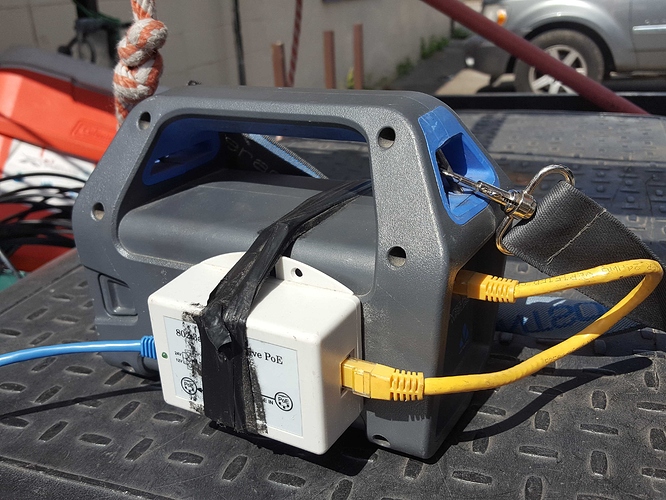

Using this for a couple of years now : https://www.streakwave.com/itemdesc.asp?ic=VAD-PSW&eq=&Tp=&o1=0 a little pricey maybe but ours is several years old now and still works while the little Geva/rebranded Geva's seemed to never last more than a few months (either the usb charging port would break, the on/off switch would break, or it would just stop working). You can set it to 2.4 or 5Ghz WiFi. It ouputs f 802.3af and 802.3at (48v 30w) and I ziptied/taped the adapter on the side to bring that down to 24v. So with a small patch cable wired to reverse pol there isn't anything it won't power including 450, ePMP 2000, Ubiquiti, Mikrotik and Mimosa radios. The battery pack is removable so we always have a battery in the unit, a charged spare and one on the charger. It lasts for weeks though depending on how much it gets used (or if you forget to turn it off).
Something we learned the hard way with the Geva's was to never ever use them on a radio that might be dead. It let the magic smoke out if you plugged them into a dead (probably shorted) radio. I have no idea if this unit would fair any better because at $400+ to find out it never gets plugged into a radio that is suspected of being dead/damaged.

They have already dropped my poe routers a few times, which broke the d/c jack so i had to replace that.
Good thing on it is i can use any router with PoE out lol. Still a pain to build and not support 450 gear. I think that part is a limitation of my dc booster board though. I originally thought it was the amp output of the recycled batteries, however i hooked up 2 60 amp 26650's yesterday to find the same result.
Also, have you ever had it apart? Would be curious to see how the eth jacks are mounted and see how hard they would be to repair
