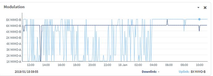

Here is the resolution to this issue for those interested.
Per Cambium Engineer Andy:
“There was another underlying bug where at the end of sending data the SM sent an extra bandwidth request because it thought a packet had gone missing, we had missed 1 packet due to interference probably,  but the AP had already allocated a slot in the next frame for this and received it. This spurious bandwidth request then meant the AP ended up allocating a slot for UL and the SM had nothing to send. Normally the SM should be able to tell the AP it’s queue is empty but in this case it didn’t and kept sending packets with zero payload and stale header information. A zero payload packet didn’t satisfy the AP (it was expecting updated header info) so it kept allocating slots and dropped the mod rate as it thought data was going missing.
The AP can now detect this condition (zero payload) and stop allocating slots, this is a fairly simple and robust mechanism for detection and correction while we investigate why the SM didn’t work as expected.”
They have tested this bug fix on a devolpmetal firmware that is currently loaded on one of our Medusa's and we have seen a dramatic improvement and stablized uplink modulation as illustrated below in the before and after of loading the dev firmware. Per Andy this bug fix will be added the the 16.0.0.2 release
