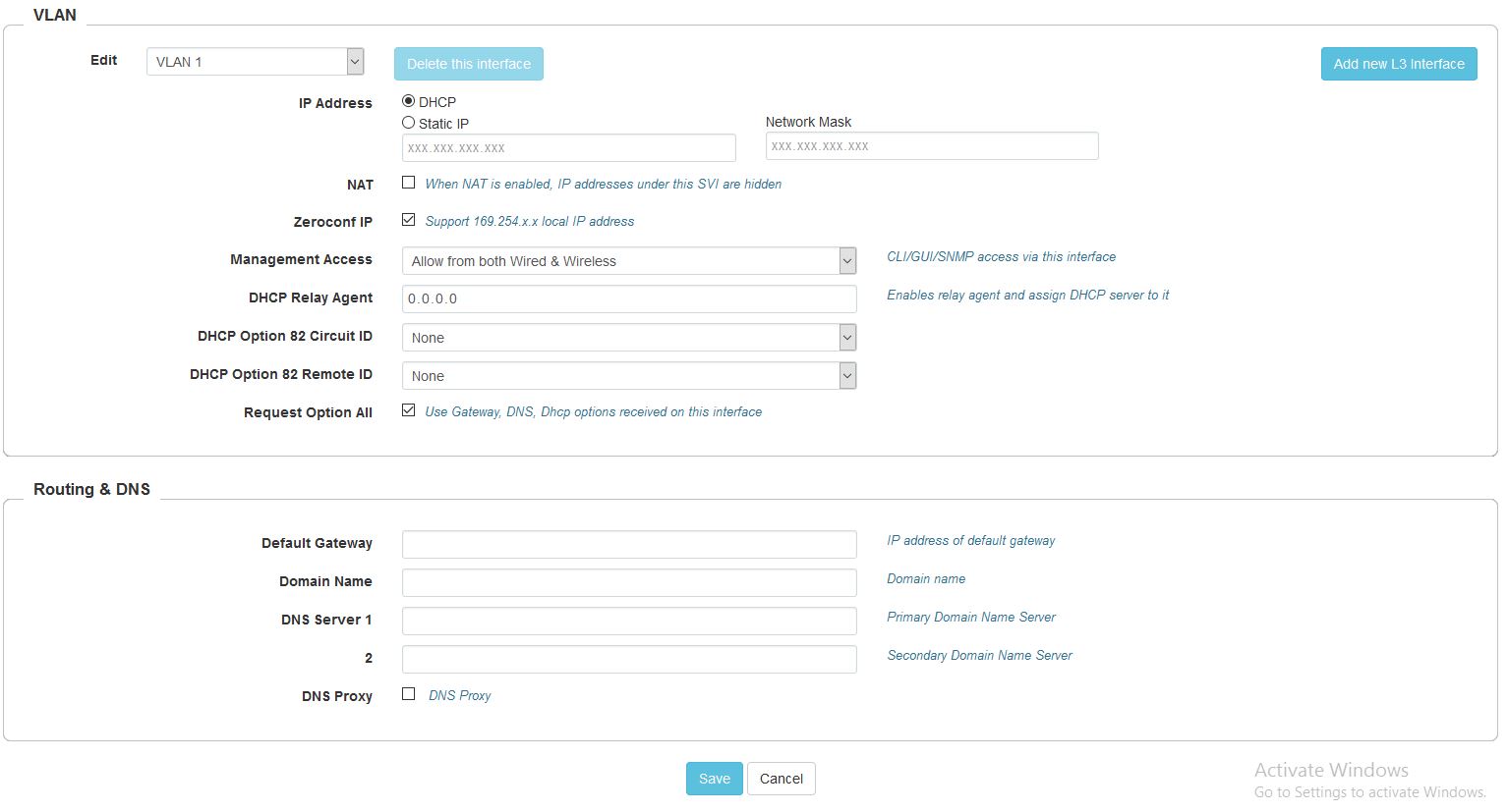

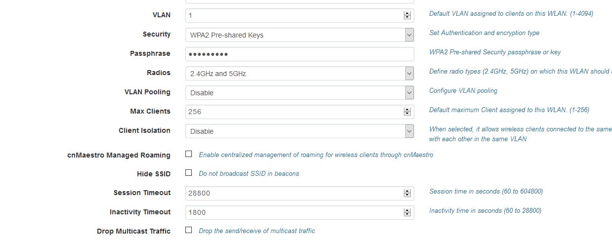

I have attached the network diagram as well as the configuration screenshot for cambium e410.
- Network Scenario Cambium issue.jpg (45.8 KB)
- Cambium-WiFi.JPG (60.1 KB)
- cambium-VLAN.JPG (72.7 KB)
