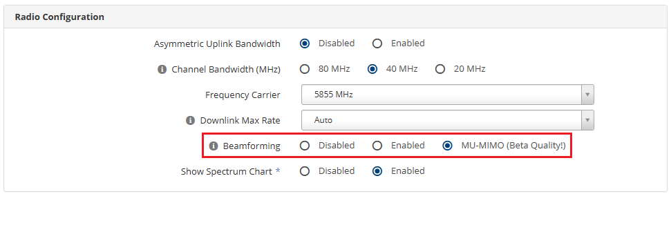

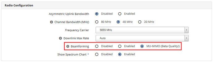

Are you using the newest firmware 5.10.3? Are you using TDD fixed or flexible mode? Did you enable MU-MIMO?

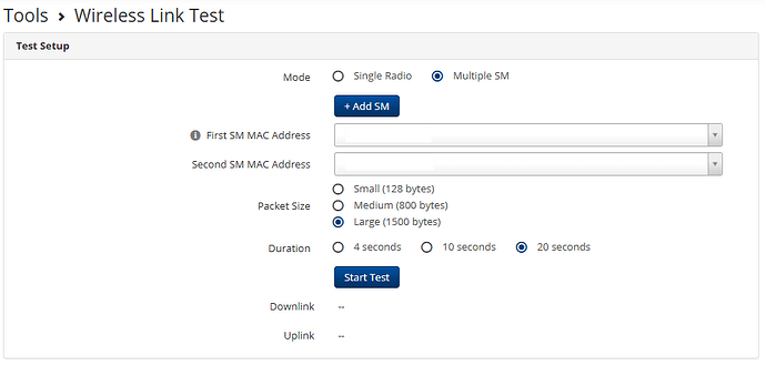

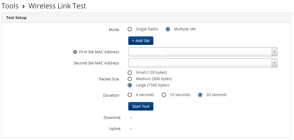

Are your SM’s spread across the entire azimuth? Have you tried running a multiple SM link test to those SM’s that are on opposite sides of coverage area?
I’m using the flexible frame. Maybe this could be the problem. I can try doing some simultaneous tests with clients at different angles. But how much different should the angles be?

While MU-MIMO does work for flexible mode, when it was released in 5.10, its status was that of “Performance optimization is pending for Flexible TDD ratio configurations.” I’m not sure how much has been optimized since then in the newest release, 5.10.3. Eventually it will be fully optimized as it was with e3k. There are a bunch of MU-MIMO performance optimizations planned for the upcoming 5.11 firmware release. You can read about this and more in the official firmware new feature release post:

Well, one of the things to remember about MU-MIMO is that it’ll only be triggered if link needs it to deliver the requested data. So for example, if you are set on 75% / 25% in 80 megahertz, you may see very little MU-MIMO because all the data requested maybe serviceable in SU mode. If you change your settings to 50% / 50% in 40 megahertz, the MU-MIMO may jump up dramatically in order to deliver the requested data.
So likewise, going into flexible frame may perhaps lower the need for MU-MIMO as the link may be able to deliver the data in SU mode with a flexible duty cycle without needing to envoke MU-MIMO. .
