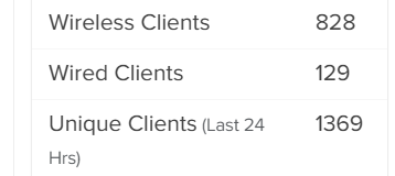

We’ve more than 1000 currently:
Hi Andrew,
Thanks for your reply.
The unique clients only show how many distinct devices were connected over the last 24 hours, but not how many were connected simultaneously.
On our on-prem server, when I add the wired and wireless clients together, we reach between 800 and 900 end devices—though so far, it’s never been more than 1,000.
As I said, I don’t think there’s any truth to the rumors, but I’d still like to get it confirmed beforehand.
Do you get over 1,000 if you add the wired and wireless clients together?

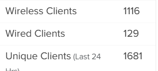

Our cambium APs handle the radius auth so I wouldn’t think that they would care what is being shown on the cnMaestro dashboard. They will serve as many users as the hardware allows.
You can definitely have more than 1,000 clients.
Hi Mitchell,
Thanks for your reply and the picture.
