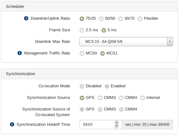

Hello,
First time Cambium user.  So I upgraded the ePMP 1000's firmware as well as it's GPS firmware.  It won't however allow me to enable Co-Location Mode.  What am I doing wrong?  I have attached a couple of screen shots.  Sorry they are dark.  I was getting the connection lost at the top of the screen when I took them.
The GPS module is working and connected to 8 our of 10 satillites.  Not sure what I have wrong.
So I figured it out.  If I have my frame length set to 5ms, I can't enable or disable Co-Location Mode.  But if I choose 2.5ms it allows me to enable or disable it.  So I enabled it and choose 5ms and it looks like it stayed enabled, but now if I wan't to disable I need to choose 2.5ms again.
Is that a bug?  Or isn't Co-Location Mode supposed to enabled if running a 5ms frame size?

So, right now it's enabled, but greyed out because I set the frame lenght back to 5ms.  Since it's greyed out does that mean it's not technically enabled then?
