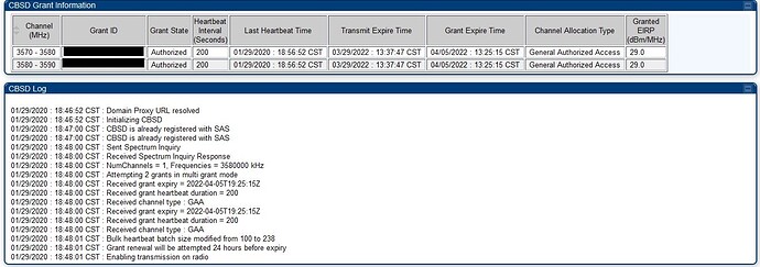

CBRS Log at the time of the issue
CBRS Log after a reboot
Why is your radio’s system clock off by over 2 years and 2 months?
NTP issues with the site.
So CBRS relies heavily on time/date related things happening accurately between the radio and the SAS. I’d strongly suggest that you try to get this fixed and possibly try release 21 as there are a number of CBRS related fixes.
I second this. NTP is critical with CBRS.
OK, we will focus on getting the NTP issue corrected and go from there. Thank you!
