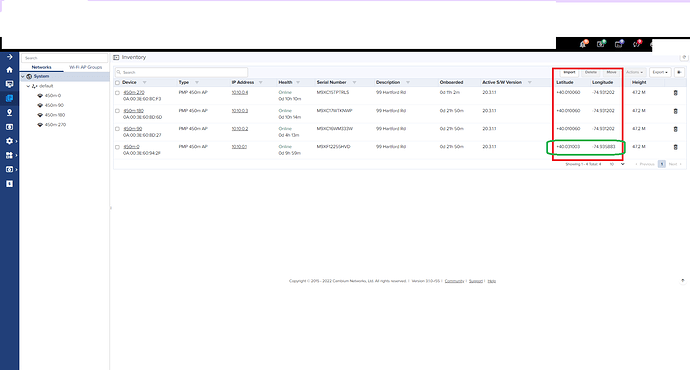

I am difficulty in correcting value for Latitude for an AP. I am using CnMaestro to do it, but even after putting the correct value and hitting Apply Configuration, the previous value shows up.
Any other way I can do this?

I have 4 access points, somewhere onboarding them i may have input wrong values
Should I delete it and onboard just this device?

Thanks very much for your help, I tried the using the map as well. I then went ahead and ‘deleted’ the AP, and used Serial number to onboard the device. At this point, I was prompted to enter the location again, which i did, but it went back to the previous address.
I logged into the AP and tried using the config file, downloaded the file, edited the file with the correct location and uploaded, but the upload failed with multiple reasons.

Hi Raghvendra, Hi Eric
I got this resolved with help from Cambium Support, Srimani and Subham
What I learnt was starting from the CBRS tab to add the AP, which registers the MAC and MSN with SAS.
in summary step 1:
delete the AP from Onboarding tab if it was onboarded previously.
step 2: go to CBRS tab and add the AP with MAC and MSN and put the location details
step 3: This also onboards the AP in the Onboarding tab which i should “Approve”.
Followed by, going back to CBRS tab and performing “Sync Config”
I checked the onboarding tab and also the AP, they show the ‘correct’ location details
My issue is resolved but some work may be required on CnMaestro to facilitate location details update when this ticket was opened.
