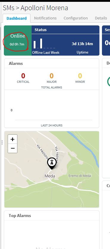

Upgraded today and in testing now.
The draw line between Tower and SM works (CNSSNG-10730) but will be helpful if there's a draw line on the map in dashboard too! (aattached file 2)
Another thing (but maybe is not a bug), now the uptime/downtime timer don't is readed in the SM (or AP) but start from the cnmaestro update (or virtual machine rebooted). Correct?
Exemple:
There's a SM powered from 10 days but cnMaestro shows 5 minutes (cnmaestro package updated 5 minutes ago)
There's a SM turned off from 10 hours but cnMaestro shows 5 minutes (cnmaestro package updated 5 minutes ago)

Hi Telemar,
Regarding the device uptime and online or offline. cnMAestro device dashboard shows online/offline time wrt the websocket connection open/close with the server in the status widget. Also the device uptime is shown in the same status widget seprately. In the screenshot attached by you Online time is 07 minutes which is the device connection time with cnmaestro and the device uptime is 3days 13hours 14 minutes which is fetched from device directly when it communicates with the server. If the device goes offline then the uptime will be updated on its next successful web socket connection with the server. Please let me know whether this clarifies or you need more information on this.
Thanks,
KR.
