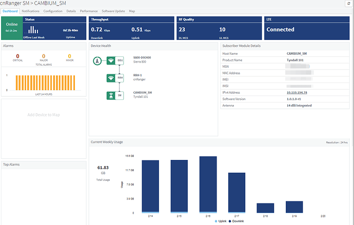

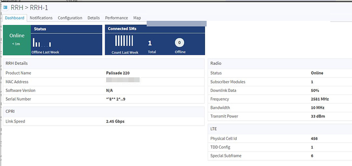

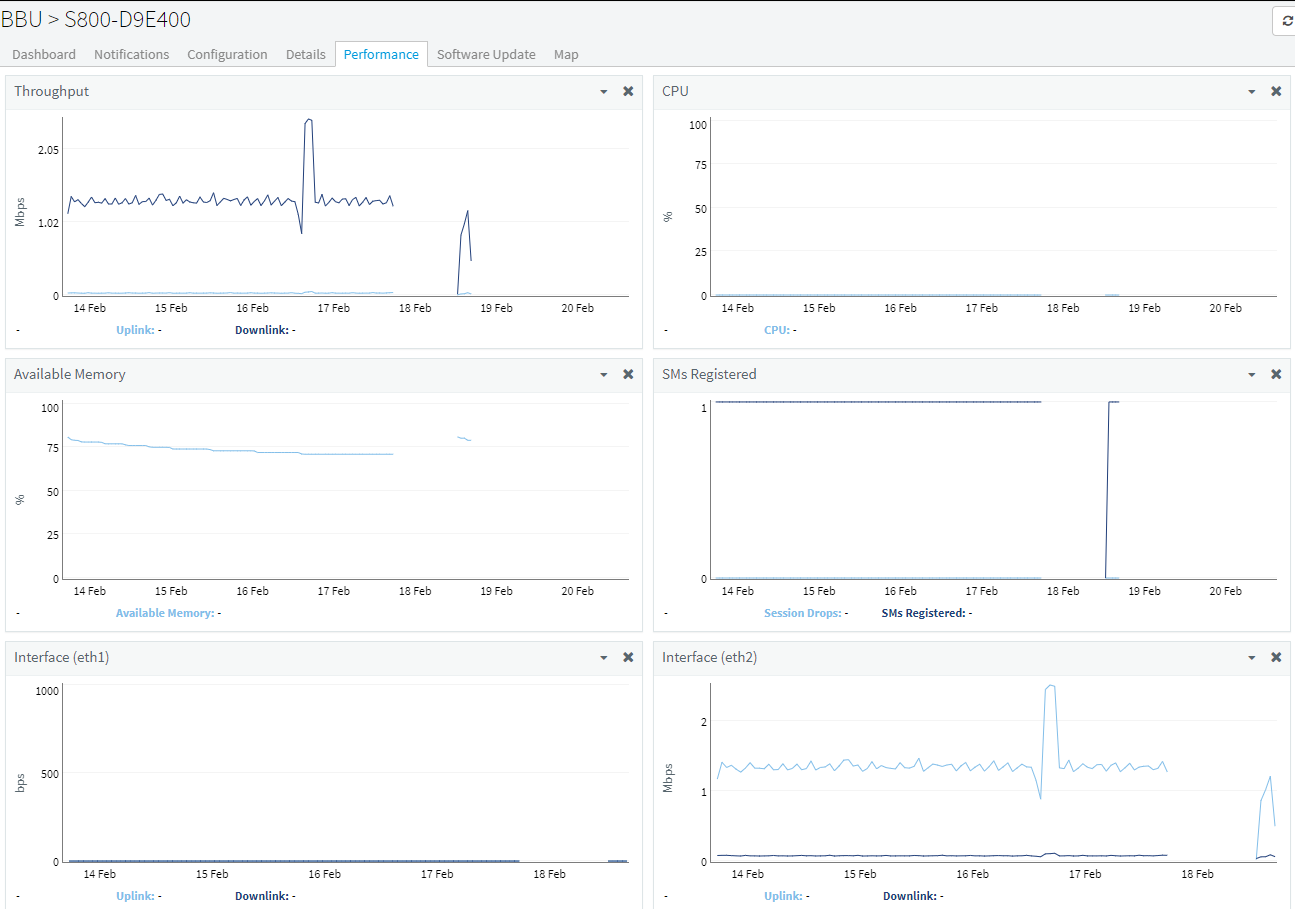

cnRanger Support
cnMaestro supports the following monitoring and management functionalities on cnRanger.
Feature |
Details |
Onboarding |
Onboard cnRanger using MSN. |
Dashboard |
BBU/RRH/SM Dashboards. |
Notifications |
Events and Alarms. |
Performance |
Performance graphs with the following metrics: · Throughput · SMs Registered SMs · Interface Throughput · CPU Utilization · Available Memory |
Software Update |
Bulk software update. |
Data Report |
CSV-based Data Reports. |
cnRanger BBU Dashboard
cnRanger RRH Dashboard
cnRanger SM Dashboard
cnRanger Performance
