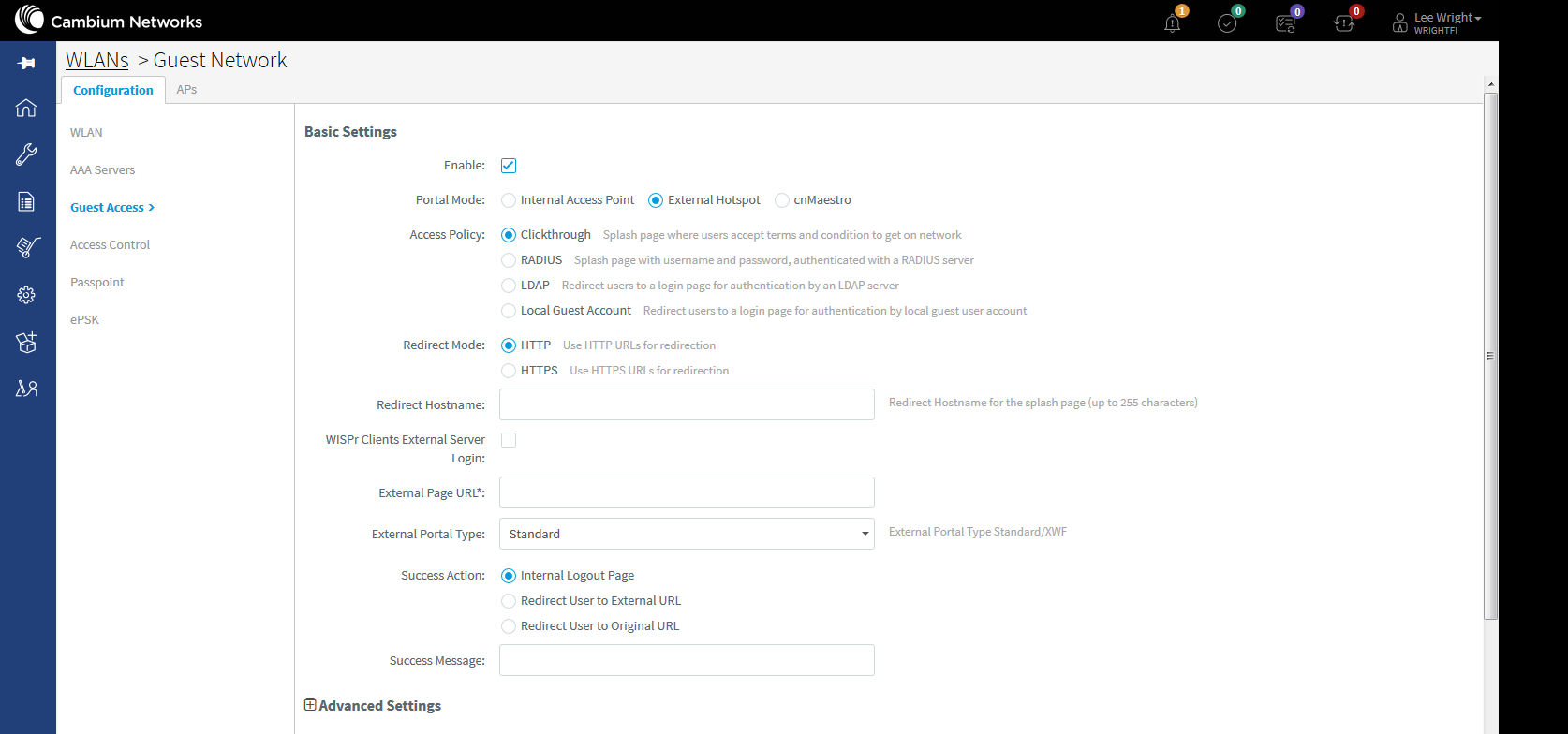

can any one help me how to setup an external hotspot via mikrotik? I am trying make users authenticate through mikrotik.
please help :-(
You can select "External Hotspot" under the "Guest Access" settings of your WLAN. From here you need to add the details about your hotspot setup and Mikrotik router.
