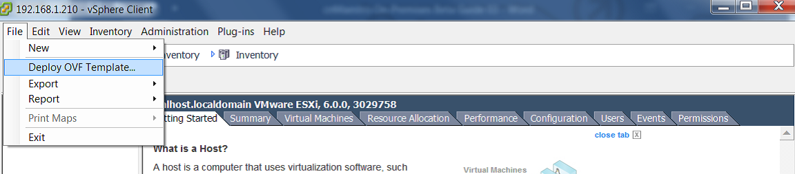

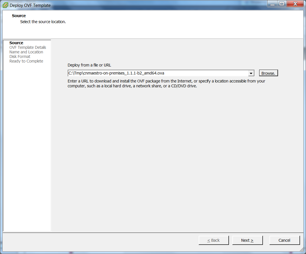

Procedure:
1. Download the OVA file from the Support site.
 2. On the VMware select File Deploy OVF Template.
3. Select the Downloaded cnMaestro OVA File.
