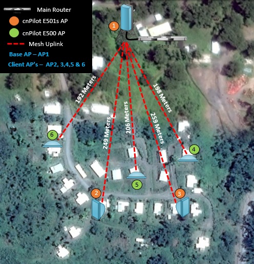

Attached is the network diagram & Wi-Fi Analyzer Reports for all AP's.
- AP's are deployed at the Gold Mine staff quarters where the Base AP(Main) is mounted on a 25M Tower and client Ap's are mounted on the roof of staff quarters (Wooden buildings)
- Max users at peak time sits at 50
- No third party wifi AP's but only 2 to 3 ISP links - not much inteference, site is idle.
Thanks.
