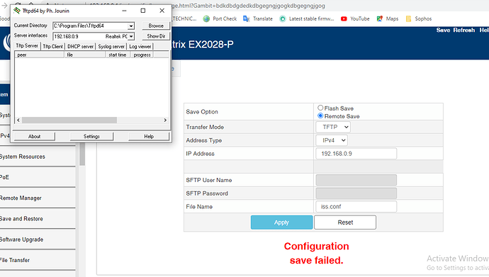

I tried to save my configs so i can transfer them to another cnmatrix but it failed
Turn off firewall or make rule to open tftp from the switch.
I turned off Firewall but still it failed
Antivirus ? is disabled too ?
For example Eset is blocking everythink on tftp
Same error on any browser ? Did u try on edge or firefox ?
Hi,
By default the switch will save the config into file ‘iss.conf’ on the remote TFTP server. Please make sure the file iss.conf is already present in the tftp directory prior to the save action. This is required by tftp. You can use a notepad to open and save the empty file iss.conf.
You can also use different filename as shown below to match an existing file on the tftp server.
