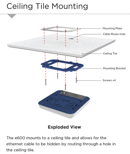

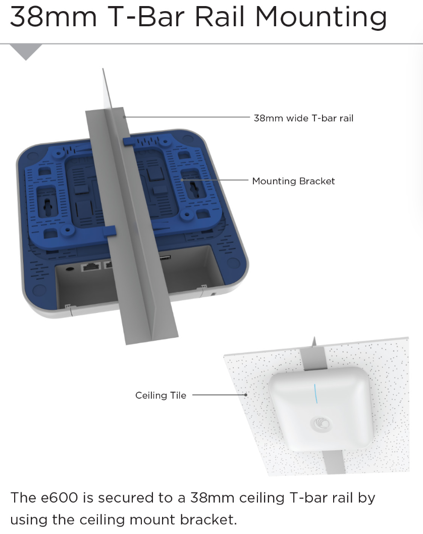

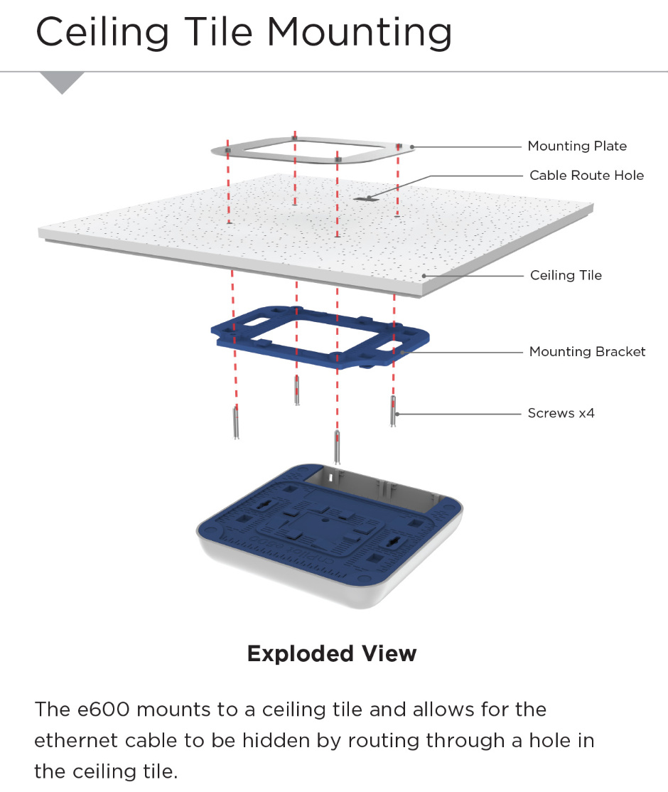

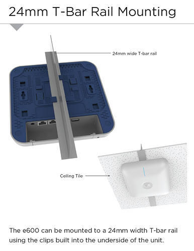

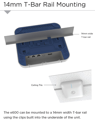

The cnPilot e410 and e600 Enterprise Wi-Fi access points support various mounting options for ceiling and wall installations, depending on your deployment.
Ceiling Tile Mount 14mm Wide T-BAR 24mm Wide T-bar 38mm wide T-Bar Wall mount
