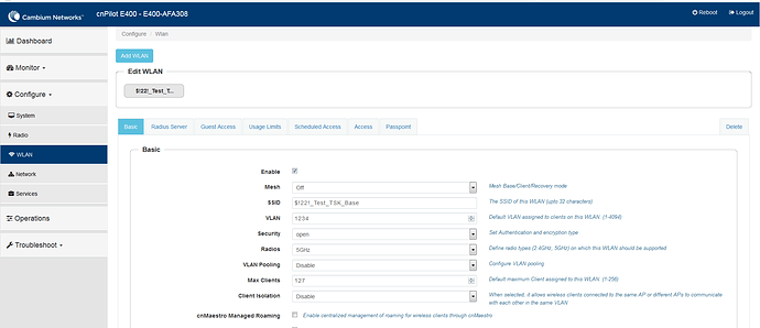

Please do the following:
  • Create a new VLAN interface with static IP and NAT enable
  • Configure DHCP Pool
  • Configure same VLAN as in step 1 in WLAN VLAN
Please let me know if you have any query.
