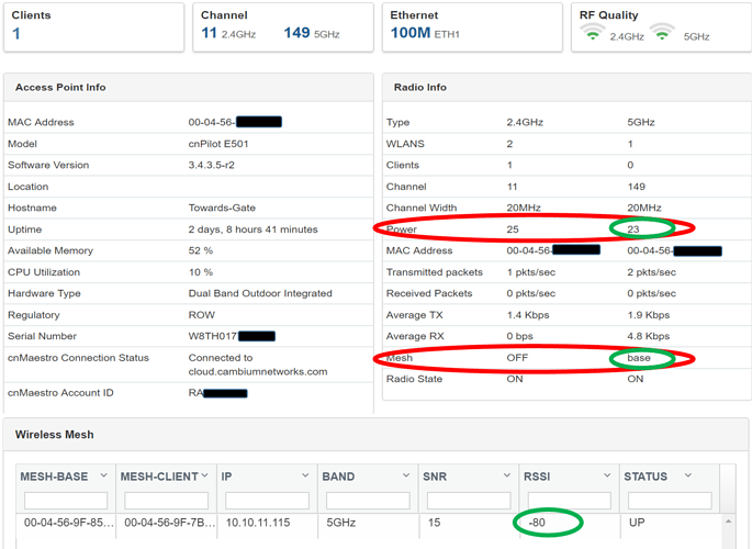

Just recently deployed 3 e500's in a Mesh network on 5GHz and public wifi on 2.4GHz.
The two clients are seeing the Mesh AP at around -60dB, however the AP is only seeing the clients at around -80dB.
AP is  transmitting at 25dBm, but the clients are only transmitting at 3dBm.

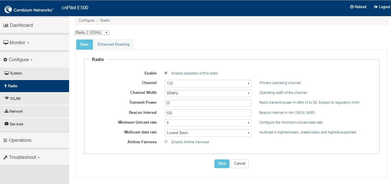

Thanks  for your response.
Transmit power is set to 30 on the radio configuration page:

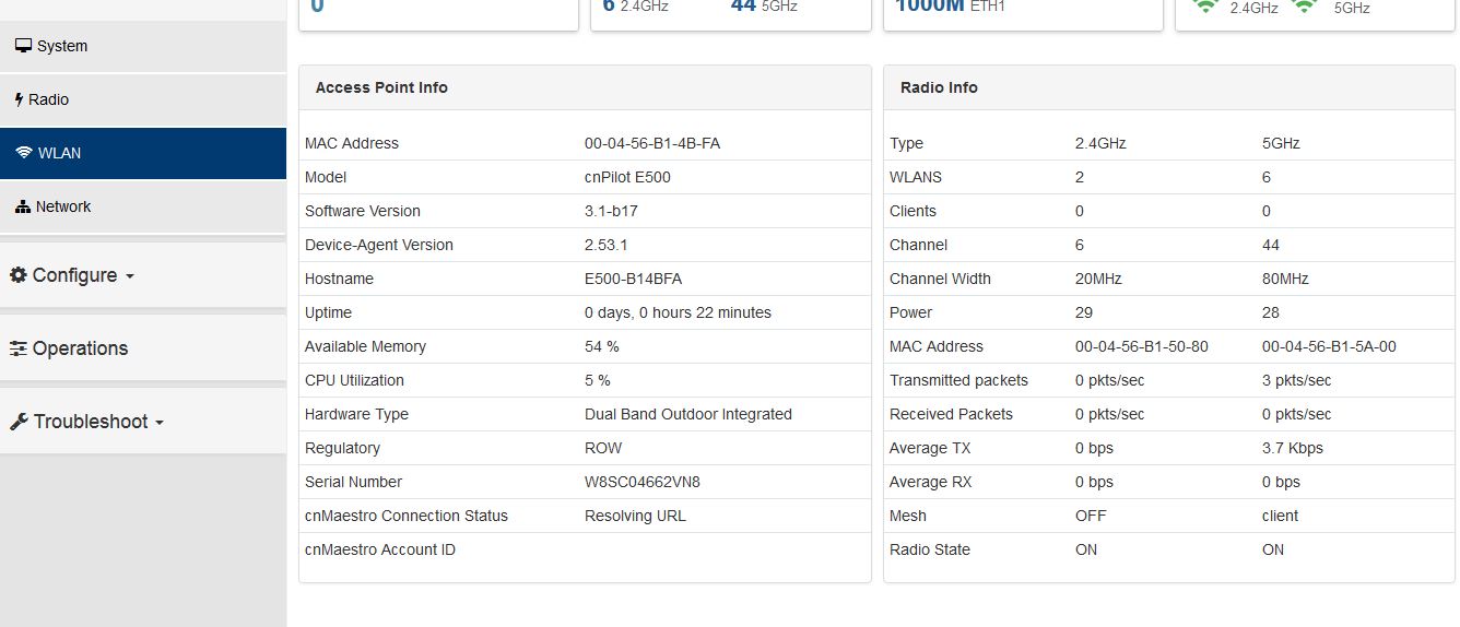

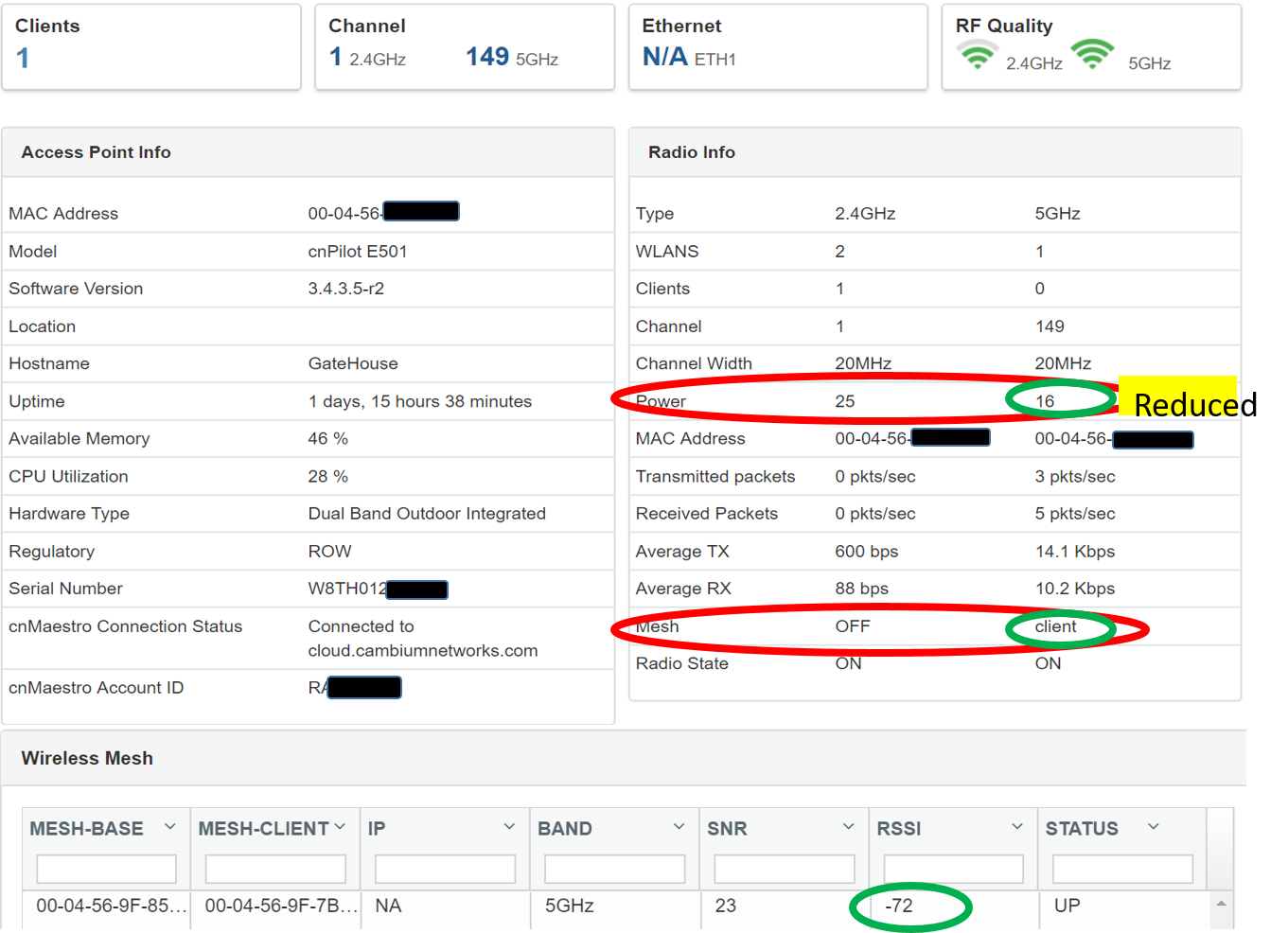

This is not working for me.
I set transmit power in radio config to 30 and it takes ok.
But in operation, mesh client is transmitting at only 3dB.
I've attached screenshots of AP and Client config screens and also dashboard of client showing just 3dB.

I am experiencing the same issue. The actual transmit power on the mesh client is reduced from the configured setting and is reflected in both the AP dashboard page and reported RX level at the Base unit.
