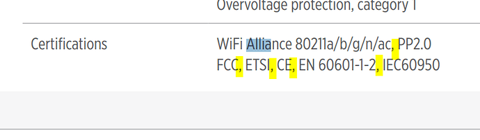

In the documentation that I once downloaded, there is information about the WiFi Alliance certification for E505
I checked the certification program, it was never released for the E505…
Older brochures contain information about the certificate, but not the new one. The shops / distributors are repeating your mistake, also an old brochure exists on your cdn!
Have you sent the E505 for certification to the WiFi Alliance for PP2.0
Can you explain ?

Can you show me exactly which fragment confirms the HotSpot 2.0 certification in the WiFi Alliance?
Yes, it’s true it has never been there and it is true as well as with the leaflet.
I’ve attached the Data Sheet in the thread, that I downloaded some time ago, which contain about certification :slightly_smiling_face:
I know about e500 / e510 / e700 WiFi Alliance certificate , wonder how the information about cert was released, after some time Cambium changed it, never seen such move from other manufacturers

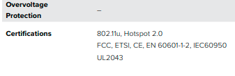

In his defense, the early data sheets claimed very clearly that the 505 was certified, and the later datasheets did not. You can see, this is the same list you shared, but in the new datasheet:
WiFi Alliance was removed from the list entirely. I don’t think the problem was about punctuation or attention to detail on the customer’s side as Cambium either had an error, or was hopeful about certification and couldn’t get it. I recognize this is just an error on the part of Cambium, but it can be frustrating to base decisions or plans on erroneous datasheets.
