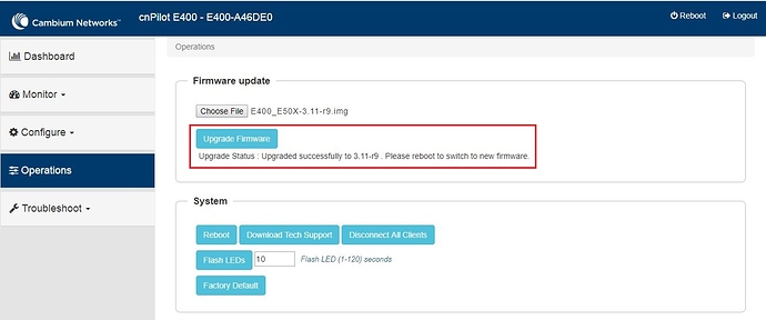

  1. Upgrade from the device GUI:
Navigate to device GUI: Operation>>Firmware update. Choose software file (.img format) and click upgrade firmware button.
Firmware upgrade is in progress.
Flashing the firmware.
Upgraded successfully and needs reboot.
Reboot the AP.

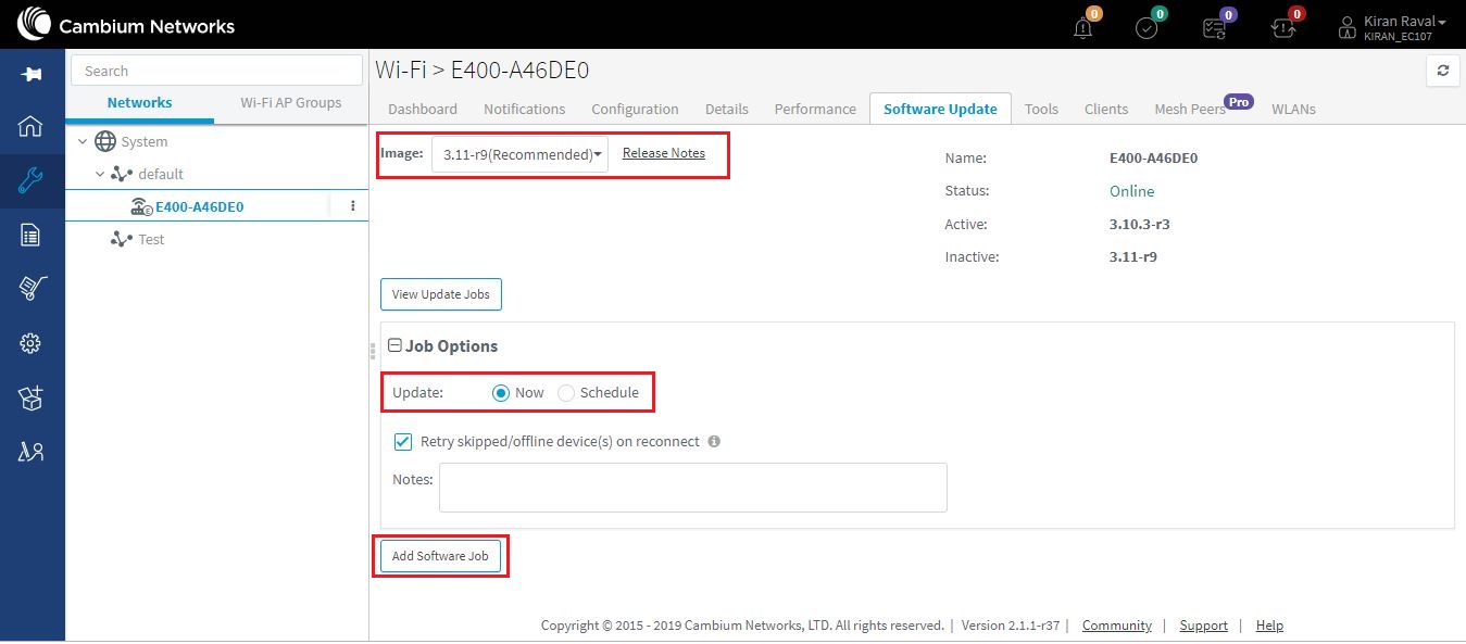

  1. Upgrade from the cnMaestro:
Navigate to cnMaestro: Manage>>Software update. Select software image from drop down list and Start Job Now option. Then click on Add Software Job tab. It will redirect to Application >Jobs page.
Click on “Show more” to view job status.
Rebooting the device.
Successfully updated.

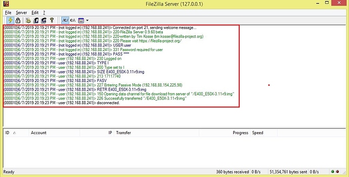

  • Upgrade using FTP server:
Here, I have used FileZila Server application as FTP server. First, Open FileZila Server application and go to Edit>>Users.
Add User.
Configure Username & password
Select Root Directory.
SSH to the AP & run command “upgrade ftp://user:password@<HOST>/firmware-file.img”.

File download logs on the FTP server.
