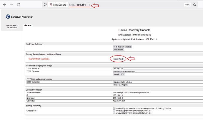

  2. While in Recovery Mode, the V1000 will be accessible at http://169.254.1.1/
    Configure your laptop with a static IP address in the same range, such as 169.254.1.100.

  5. On your laptop, open a web browser and navigate to http://169.254.1.1/
  6. Click on Factory Reset to initiate the recovery process.

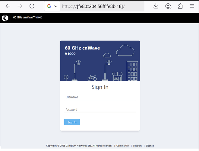

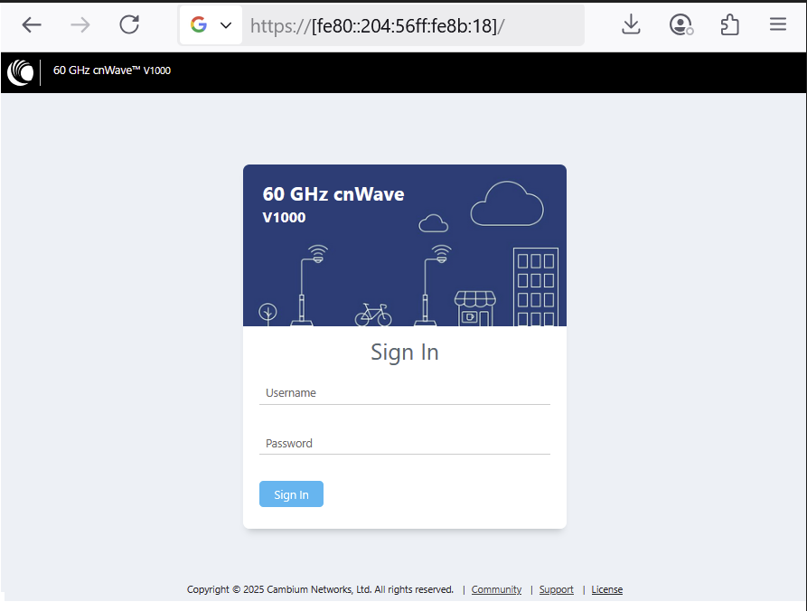

Note: Compute the link-local IPv6 address corresponding to the MAC address of your V1000 and perform continuous pings from your laptop. IPv6 pings should work successfully when the V1000’s LED is solid green. You should then be able to access the V1000’s GUI via its link-local IPv6 address, after which a factory reset can be performed.
