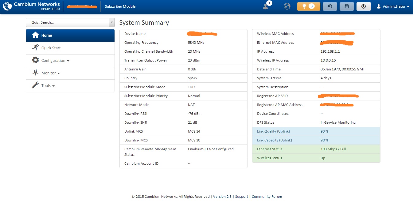

2 weeks ago i placed a sector with epmp 1000 sync just to test it in my area...
here we used to use ubiquiti gear... we started to change clients from ubnt to epmp ...with excellent results.
today in taht sector we only have 4 clients connected, 1 of them is connected..the rest losses connecttion with ap...
all of them are in the same area...
levels are in the file attached
in ap´s log shows:
 aid=3 disassociated. Reason: COMMUNICATION LOST
it has been working fine for about a week, i really want to change to epmp due to the better quiality and stability  (that is the problem i have with ubnt, and of course ..speed are higher with less bandwith , not like ubnt...)
regards
Hello GINEBRA254,
First of all you have to check Network Entry RSSI Threshold parameter on SMs (Configure->Radio) whether it match with RSSI level.
Then check Noise Level on SMs and AP. You can use eDetect Tool or better to scan used frequencies by Spectrum Analyzer.
SMs may lose connection due to high interferer level.
Thank you.
Hi GINEBRA254,
Have any of the three SMs come back?  If so, can you provide these logs, too?
Dan
thanks dan , they still come and go...
ive tried with edetect and detect low interference
about log.... all sm just show info about PPPOE nothing about disconnections
anyway RSSI is quite low...
im using epmp1000 sync + cambium 90º sector
on client side... force 110 properly alignned ...but RSSI in -76 in the best case
the 3 SM are in the same area ...no further than 200 metres bettwen sm 1 & 2 and sm 3 is 800 metres away from them ,
distance to ap is 2.85 km
ive seen post that people is reaching -58 dbm with same gear and distances between 6 - 8 km
ive just seen this...
both are mine... im going to change the frecuency and let you know,
a low RSSI ...could be because of 2 links in the same frec??
thanks
