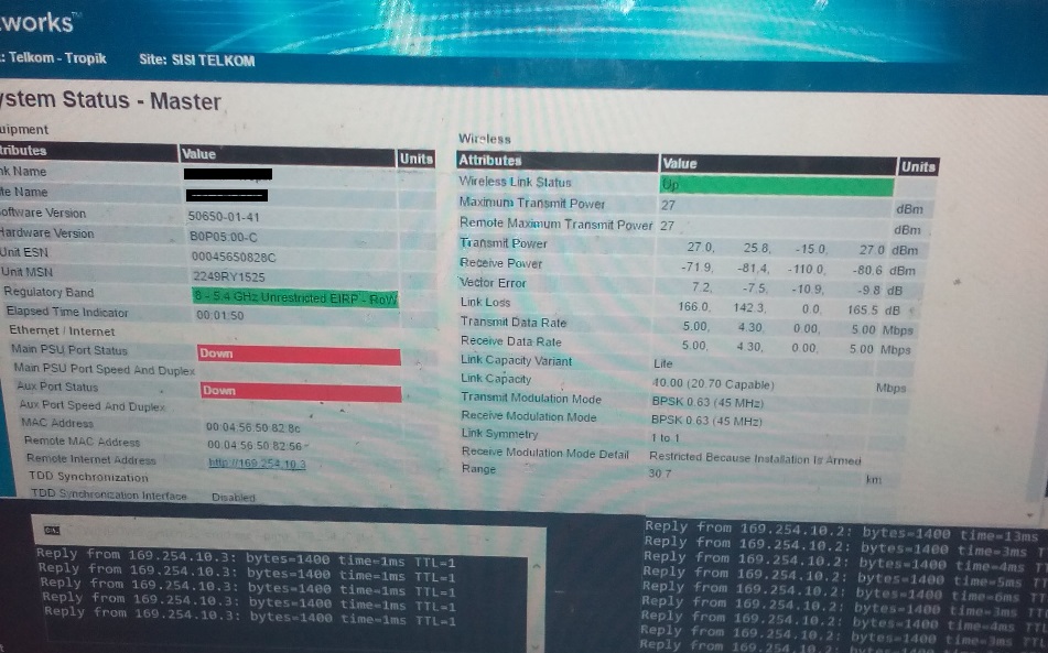

Good evening admin information please cambium PTP650 manual setting, for the master and slave karane currently I'm pairs a distance of 30 km but only got 5 mbps, los field conditions.
send screen shoot please.

Two things stand out:
First the received power is low (about -80 dBm) so the link is never going to achieve a high modulation mode. The link loss is 165 dB. What did the LINKPlanner predict for this link?
Also, the installation mode is still armed, so the link is in any case stuck at BPSK modulation mode.

The screenshot shows the capacity as 5 Mbit/s transmit and receive. This is the normal capacity for 45 MHz bandwidth, BPSK modulation mode, and PTP 650 with the Lite license.

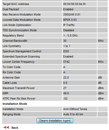

The link is stuck in BPSK because the installation mode is armed. You cancheck this by an alarm on the System Summary like this:
If this is still the case, disarm the installation mode by returning to the Installation Wizard, like this:
Also, the link loss is very high at about 165 dB. This may be related to a non-line of sight path, and the relatively long range. Please use the LINKPlanner to find out what link loss is predicted. If the measured loss is much higher than the prediction, then either the link needs to be alligned more carefully, or else there are obstructions that are not included in the LINKPlanner prediction. To address this, please review the path of the link and check to see if it matches the terrain profile in LINKPlanner. You might need to add additional obstructions to model trees or other objects in the path.

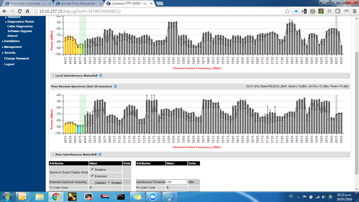

Also, look for the best band. enable extended spectrum scaning (spectrum expert page)

your 5.8 spectrum is very noisy... are you allowed to use 5.4. or just test just to confirm whether you actually have a good LOS conditions.
for this case i see your problem is the interference around you. so best option is to move away from this range. we have a 41km link at an los condition and PTP650 really works great at a slightly less interfered frequency.
