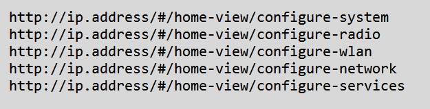

FYI, you can still get to all of the gui settings that used to be in the 6.x code, cambium just removed them from the gui menu system. If you type them in your browser after logging in to the gui they still work:
I hope after seeing this Cambium won’t remove these entirely, and conversely, will put them back in the gui menu. I get that they want to push everyone to cnMaestro, but for local troubleshooting it’s much easier than fiddling through the CLI, or fumbling around in cnMaestro.
These are confirmed working on the X7-35X running 7.0-r5 code, not sure about the 7.1 code.

It’s just horrible. The latest v7 beta is out and Cambium has completely removed the URLs I posted on July 15th. Cambium clearly has taken their eyes off of their customers. Hopefully this is just a ‘beta’ issue. If not, Cambium, please restore this much-needed and much-used functionality.
@nicnic_94 It’s just horrible. The latest v7 beta is out and Cambium has completely removed the URLs I posted on July 15th. Cambium clearly has taken their eyes off of their customers. Hopefully this is just a ‘beta’ issue. If not, Cambium, please restore this much-needed and much-used functionality.
