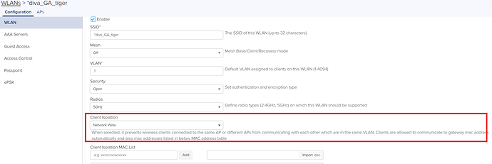

Hi,
From your comment, my understanding is that your Guest wifi network is also in the same production LAN but you don’t want wireless clients to access production LAN network after doing Guest access, it should reach only internet. If that is correct, you can enable Guest access and configure “Client Isolation-> Network Wide” in the WLAN, by doing this wireless client will not be able to reach any IP’s on the same network (in your case production network), it can reach only internet.
Please let me know, if above configuration will suffice your requirement, else we have to create separate vlan, DHCP pool for Guest clients, which also can be done via CnMaestro itself.
Yes thanks, this seems to be the very simplest solution. I don’t really care about VLANs or any of the other. I just want a Guest WiFi network, in which the guest can only get to the Internet, and can’t see my production network.
