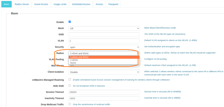

  4. Under Basic tab there is a option to configure Radios(see the image pasted below) , using this option you can configure different SSID for different radio’s
I am still confued ,If I add 1 radio as 5 ghz then how do i add another as 2.4GHz
  1. Add WLAN give WLAN number as 1 and configure SSID for 5GHz, by selecting radio as 5GHz
  2. Again click on Add WLAN and give WLAN number as 2 and configure SSID for 2.4GHz by selecting radio as 2.4GHz
Same way if you want to configure multiple SSID’s then follow the same procedure**(Login to AP → Configure → WLAN → Add WLAN (give WLAN number) and Save the conifg)**
yes thanks,i didnt see add wlan at top
