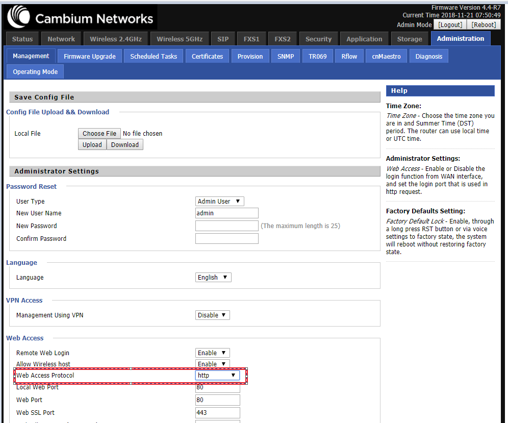

Due to security resons , we have disabled HTTP access by default  in newer firmware versions. So try using  HTTPS to access device https://192.168.11.1 . Let me know if it doesn't work.
If you want to enable http access once you have logged in using https  ,  go to adminitration tab in UI  and select Web Access protocol  as http  , save configuration and reboot device. Please see attached image.
R201P firmware is compatibale with R201

Attached image.
It's working fine now since yesterday, thank you very much! I was worried for a moment.
