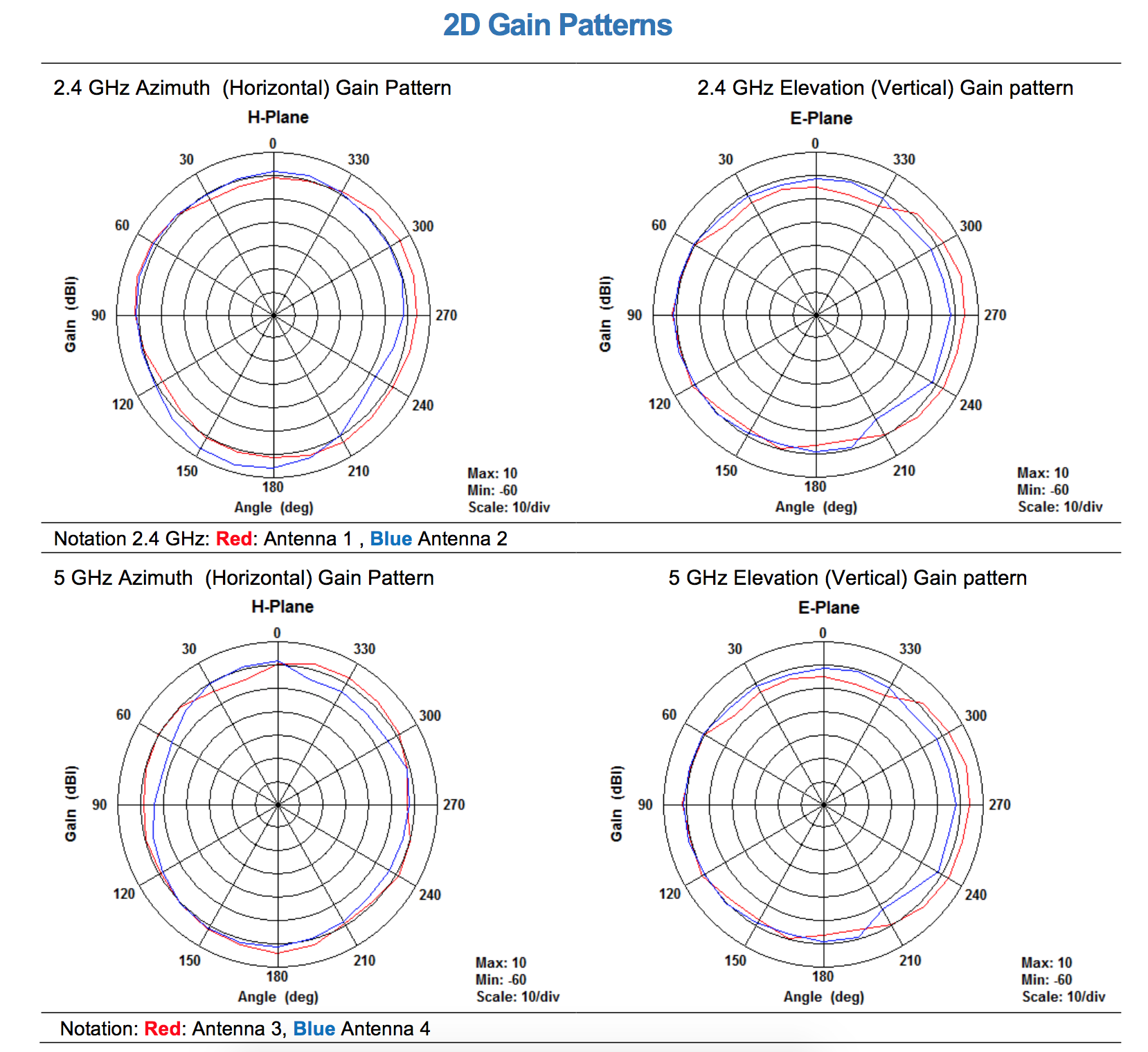

the antennas on the E500 are Omni.  here's how the antenna patterns look:
the e500 will give very good coverage in the front and back of the access point. There are 4 individual antenna elements inside the unit (two for 2.4GHz and two for 5GHz). These radiating elements are located in the top section of the access point so will do a good job for client devices behind/side/front.
