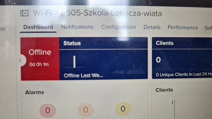

3.AND HERE is the first SILENT reboot - no message, no information to cnMaestro etc. etc. All the time the status “writing to flash memory” !!
4. After this reboot cnMaestro get a message that the device is ready for reboot and rebooting it again! 1 minute after getting up.

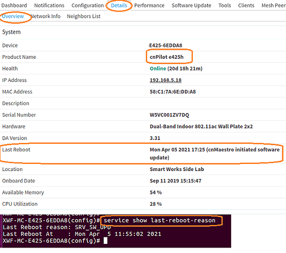

Can you check the following command output when AP went for silent reboot or you can check the reboot reason in cnMaestro page under “Details” tab(see the image below)
“service show last-reboot-reason” command output on AP
I know that all works OK but for unexpirienced users it could be strange.
As u show, reboot reason is upgrade

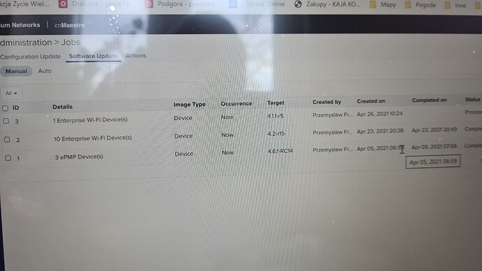

Now downgrading from 4.2 to 4.1.
Silent reboot under the update process still exist
