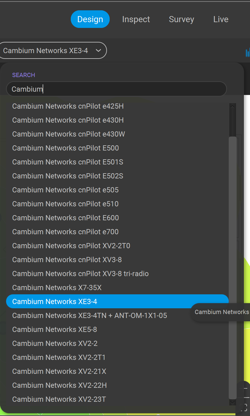

Hi Eduardo, I am using Ekahau AI Pro version 11.6.3.1 and when I search for Cambium, I come up with the below list of Cambium APs. Can you please let me know what Cambium AP model you looking for that is not in this list?
Thank you Gary,
You are correct, the Cambium models are up to date in Ekahau,

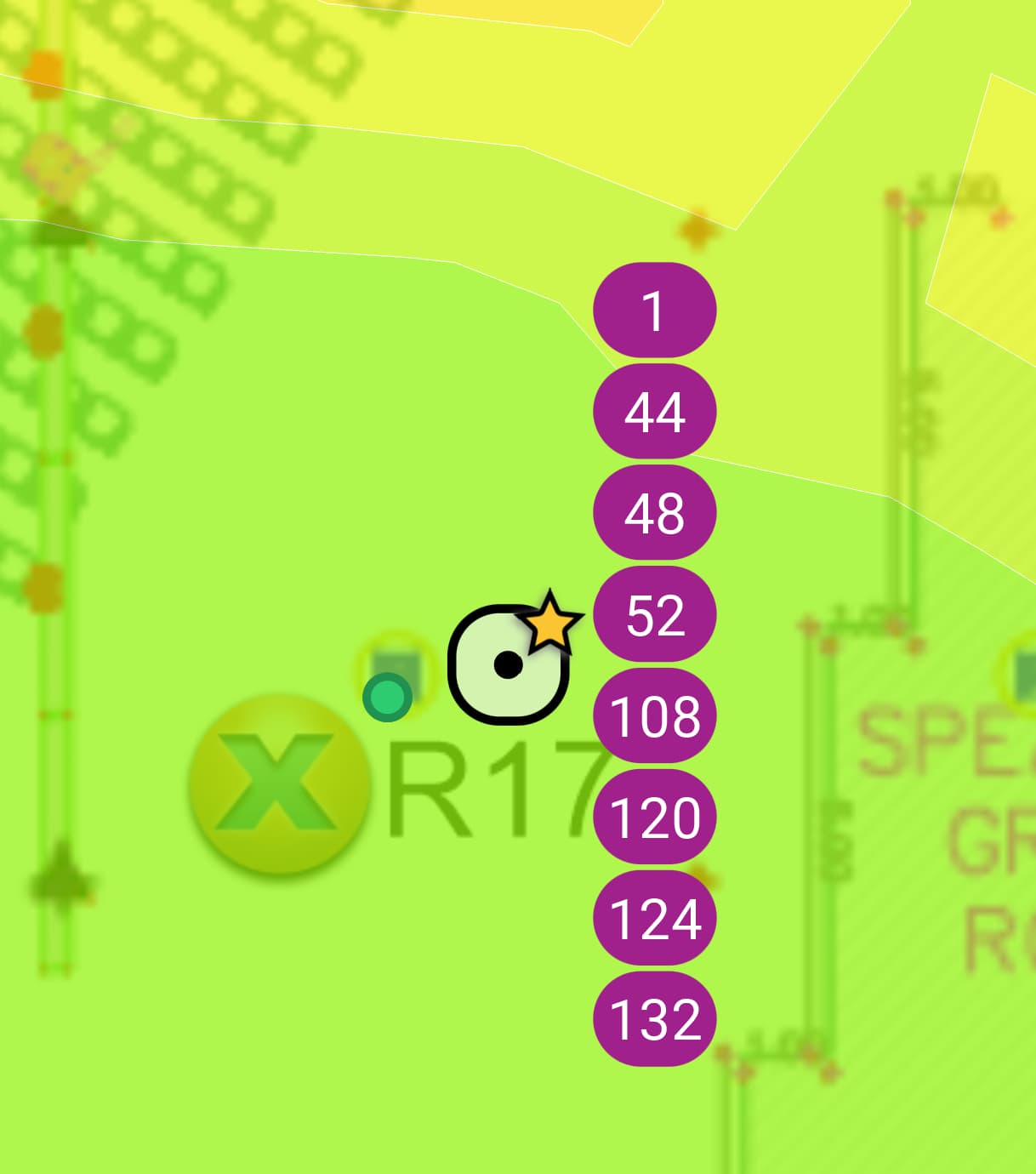

If you look at the screenshot above, there are three Cambium APs detected at the bottom right, when it is a single AP with three radios,
I attach a new screenshot where an 8-radio Xirrus is correctly detected.
