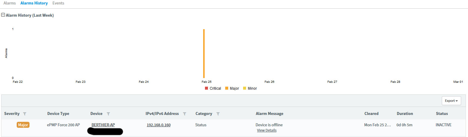

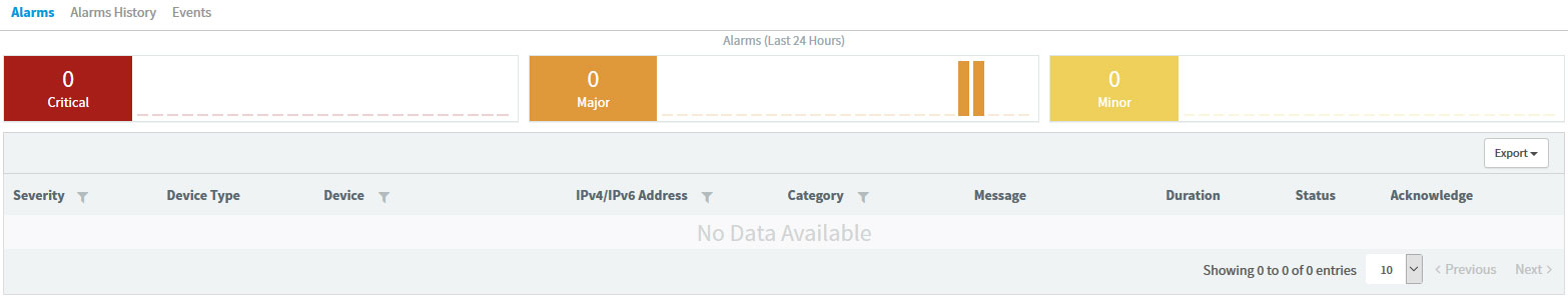

Jordan, I have an issue... Since I've setted up notifications to my email everything has been working ok, but today i have received a call from a client reporting me a SM down and i said "I havent received any notification" but when i log in to my account i have found that is down.. but there is not any alert.
The alert attahced is an old alert from Feb 25 but as you can see on the images there is not actual alert.
I havent received any email

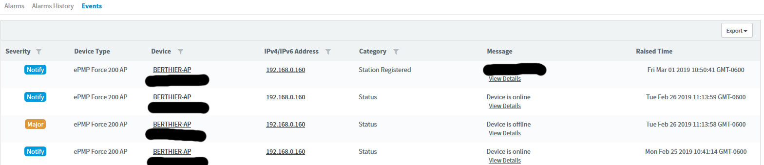

NetBrowser, are there any cooresponding events for the device going offline?  Events drive alarms so I'm trying to get an idea of where things broke down.
Hello Jordan, there is an event in SM and in AP. in history no and there is no Alarm.
Hello NetBrowser,
Thanks for the screenshots.  One of those was offline for a second or two, which would not trigger an alarm.  The other had the SM down for over 5 minutes which triggers the alarm in your "events-history-SM" screenshot.  This was cleared when the SM came back online.  Does this inactive alarm line up with when the SM was actually down?
cnMaestro will mark a device as offline after several ping/pong messages are lost in a row.  An offline event should immediately be logged then.  Only after 5 minutes of the device being down will an Offline Alarm activate.  The alarm then drives the email notification.
