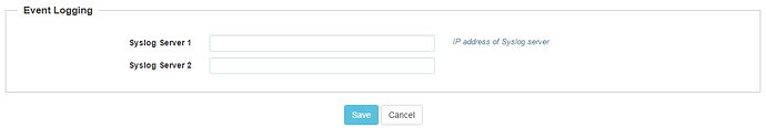

ePMP 1000 HS and cnPilot E400/E500/E501 :
Login to the device GUI and Navigate to the Configure->System and in the event logging specify the syslog server IP Address of the remote syslog server where the cnMaestro device logs needs to be captured. This will allow to log the cnMaestro and device related logs from the device to remote syslog server
Login to the device CLI using SSH and issue the following command for enabling the cnMaestro debug level .
This will allow to log the cnMaestro and device related logs from the device to remote syslog server with the debug level logging
logging cnmaestro 7
Save and Apply the settings from cli itself
Also to view the device agent logs from the device cli issue the following command
service show debug-logs device-agent
Latest log details will be shown in the top
