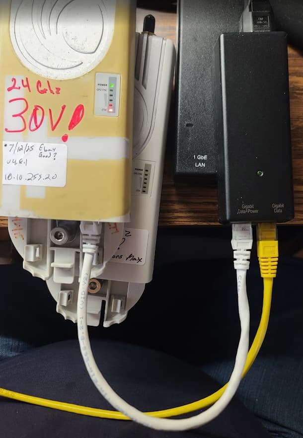

Got some 2.4Ghz ePMP 1000 with Sync off ebay and they have obviously been “refurbished” or “repaired” but so far everything works but 2 things are odd.

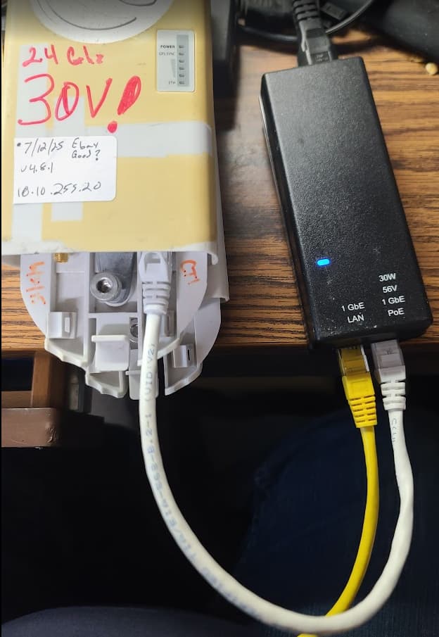

(1) They will not power up using the usual 56v ePMP power supply , but power up and appear to work fine with the ePMP 30v or connected to a Sync Injector at 24-30v ( I’m not brave enough to try plugging them into a Sync Injector at 48-56v as they tend to fry 30v radios, like 3000L).
They have obviously been taken apart and the back of the PCB where the ethernet port is is covered with flux on all of them so I’m pretty sure the ethernet port/chip has been replaced on them… was there ever a 30v only version of the 1000 with Sync or did they possibly use chips from 30v 1000 subscriber radios to repair ?

The stickers are long faded out but even if it wasn’t the stickers are on the case not the main board so the sticker and the board may or may not match. I’m pretty sure they bought the rest of the radios from the link you posted here and those tested out fine, I updated the software, uploaded a config and made sure sync worked on all of them. Then I opened a box they got from another ebay auction, and using the exact same set up, literally unplugged the last radio from the 56v cambium PS then plugged in the first of these other radios, none of them would even power up. I thought at first they got scammed, but just in case I tried another cambium 56v PS and they would not light up , at all, no flash no nothing, just dead.
They had the SMA connector for the GPS antenna and I’m thinking at this point they bought a box of dead radios. I have no idea what made me try a Cambium 30v PS but I did and was really surprised when they powered up. Honestly at that point thought they had been scammed and the seller had somehow stuck an GPS SMA connector on subscriber radio. But logged into them and yeah, they were Access Points.
Except for one of them they all appear to work just fine other than the GPS software version not updating and the fact that they will not run on Cambium 56v PS.

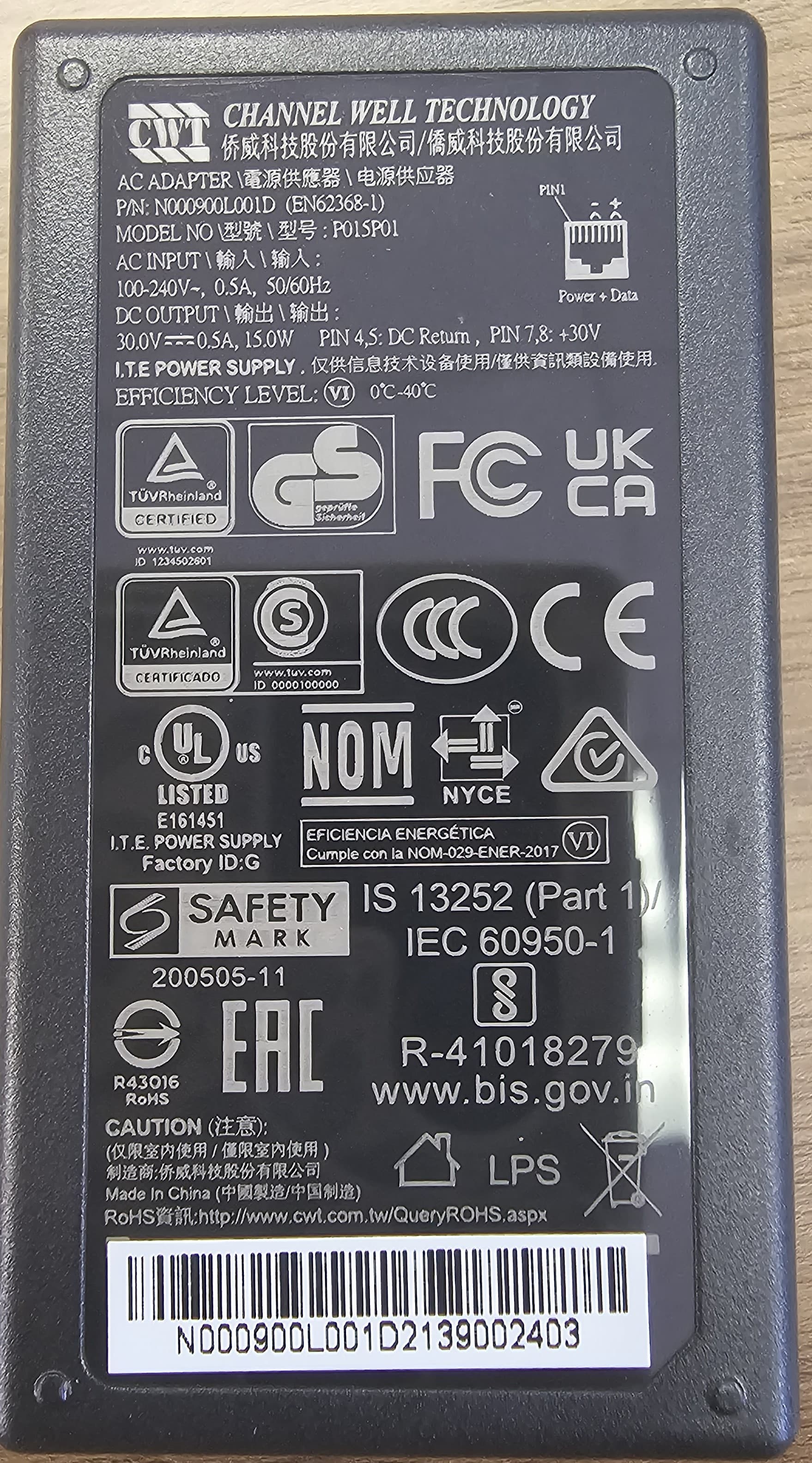

I have a new 2.4GHz ePMP1000 with GPS sync in the box. Here is a picture of the POE power supply.

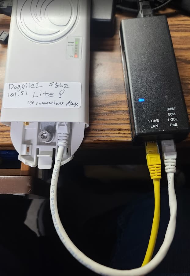

Yep I opened an old 5Ghz 1000 AP and it has the old 30v PS with the hard to read gold on black lettering. That said, my question isn’t “will they run at 30v” I know they will , it’s “why do these 6 Access Points not run at 56v” and/or “Did cambium make a batch of ePMP 1000 Sync APs that won’t work at 56v ?”

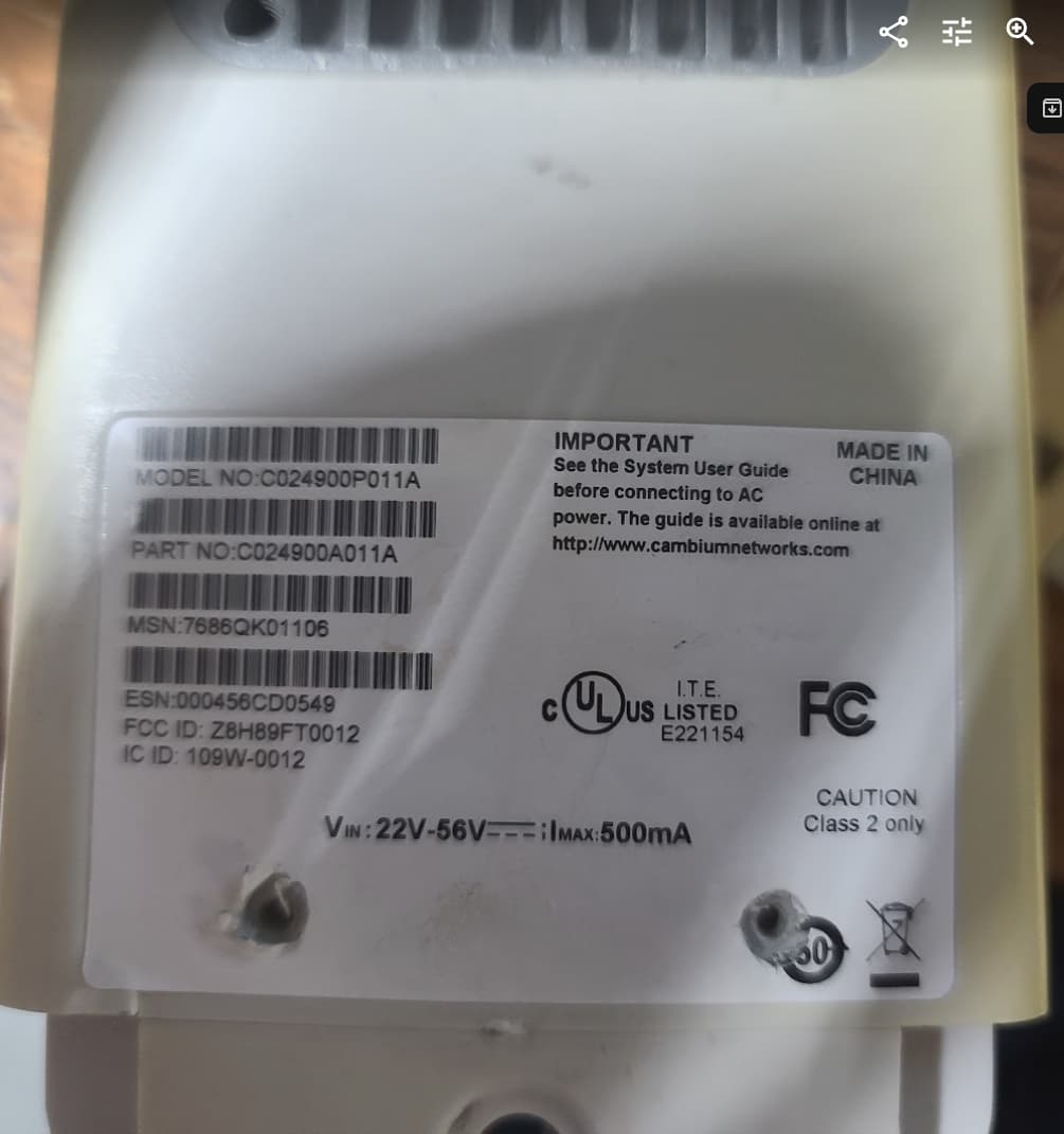

Literally the sticker on this 2.4Ghz ePMP 1000 with Sync that will not power up connected to a 56v PS. However these boards are not in their orignal cases as the ESNs on the cases do not match the radios.
