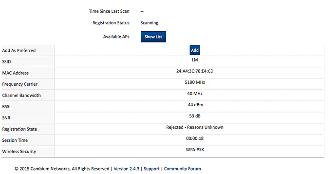

Anyone else having problem with Standard WiFi support?  I try to connect an SM with 2.4.3 to a Rocket M5 using the configuration on the inserted picture, but I could not force the SM to connect to it, it says Rejected - Reasons Unknown. If I try to disable the security, and use open , then it connects, but did not show any RX/TX value on the Rocket, and also no traffic passing through my laptop (which is connected to the SM) to the UBNT AP. On the UBNT side at the log, I see the following:
May 28 18:24:34 wireless: ath0     MLME-AUTH.indication(addr=00:04:56:cd:b0:9d)
May 28 18:24:34 wireless: ath0     Registered node:00:04:56:CD:B0:9D
May 28 18:24:34 hostapd: ath0: STA 00:04:56:cd:b0:9d IEEE 802.11: associated
May 28 18:24:37 hostapd: ath0: STA 00:04:56:cd:b0:9d WPA: PTK: Failed to receive EAPOL-Key msg 2/4 response, all tries exhausted.
May 28 18:24:37 wireless: ath0     Sending deauth to 00:04:56:cd:b0:9d. Reason: 4-way keying handshake timeout (15).
May 28 18:24:37 wireless: ath0     STA-TRAFFIC-STAT mac=00:04:56:cd:b0:9d rx_packets=0 rx_bytes=0 tx_packets=4 tx_bytes=428
May 28 18:24:37 wireless: ath0     Expired node:00:04:56:CD:B0:9D
May 28 18:24:37 hostapd: ath0: STA 00:04:56:cd:b0:9d IEEE 802.11: deauthenticated due to local deauth request
May 28 18:24:37 hostapd: ath0: STA 00:04:56:cd:b0:9d IEEE 802.11: disassociated
Looks like maybe there's an authentication issue? Maybe try using a different WPA type on the Ubiquiti radio and see if you can find a combination that works with the ePMP radio?
no, if I choose another authentication type, epmp wireless monitor security says not supported.

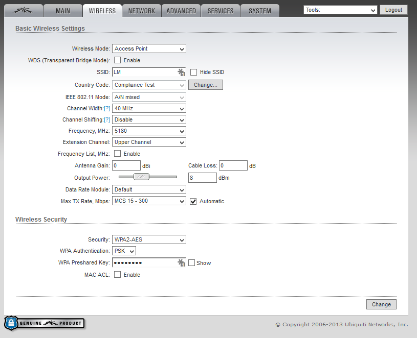

Did you turn off AirMAX on the Ubiquiti AP?
I ran into this issue myself and got past it. Please send me a screen shot of configuration > security
A.
Also try setting the Country and enabling WDS on the UBNT device.
This is correct. WDS must be enabled on the 3rd party AP for an ePMP SM to register in WiFi mode.
